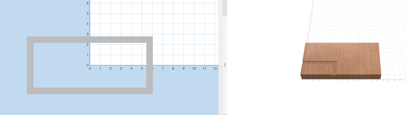

What’s the best setup to do a juice groove in a 1" thick Cherry cutting board? I have a curved bit with a 1/4" shank I can use. Looking in the design gallery imagine I could just use a rectangle, but wanted to see who else has done this and examples of how others have done this. Thank you!
What settings did you use to configure that bit? Did you add it as a custom bit? How did you define the settings? There doesn’t seem to be an option in Easel to add this type of bit. I have a 5/8" curved bit just like you described. I appreciate the help!
I have a 3/8 round bit for this. Easel did not give me that option so I just called it a straight bit. Made my path and set it to cut on line. Set the depth on the path and hit carve. Mine was an end grain board so I fed it slow. however I did get burn marks so I think its a delicate dance in the settings that you have to work through.
