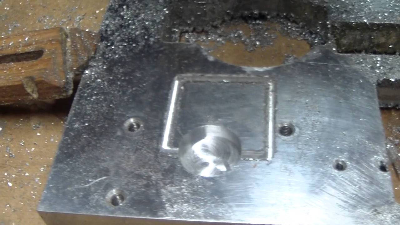

I have cooling- a mister setup spraying washer fluid. With a 2 flute 1/4" bit I can cut at 70" per minute with .01 passes. I slow it down to 35 inches a minute for my 1/8 single flute and drop to .008. And I can do 25-30 inches a minute with my 1/16" at .006" depth. All of these with my DW660 running wide open.
The MAIN thing I found is keeping the plunge rate slow.
Cutting .06" sheet with 1/8 single flute at 35 inches a minute:
The finished product:
Here is cutting at 35 inches a minute with a 1/16" two flute. 1/4" plate, I ended up slowing it down to 25IPM
And BTW, my machine is a shapeoko 2 with NEMA 17’s…
I have 3d machined 1 inch bar stock using other peoples settings like above and all was fine and I mostly use carbide wood router bits.
It cuts steel to so far up to 3/8 its all just a matter of settings and some guess work
some steel
With the cooler I haven’t needed to slow it down. Actually broke an 1/8 bit running it too slow. But I keep my feed rates high.

Dam that first piece is nice and shiny :slight_smile:
Just curious are the tool marks from using a large stepover?

I always have toolmarks- but I always use 40% step over. I’d guess they are mostly from not having perfect tram and not using optimum cutting speeds.
A problem I had when cutting aluminum was doing deep profile cuts. It was probably due to runout, (the bit wobbling) the bit would hit the walls of the channel it was cutting, bind, dig in and either break or gouge the print.
The way I fixed this was to widen the channel to about 140% of the bit diameter (with a 40% step over so it would do it in 2 passes). So that there was just a bit of extra clearance for the bit. I did this by making an offset of the outer perimeter line of 40% of the bit, They cutting out the perimeter as a pocked operation (between the 2 lines) rather than as a profile cut.
