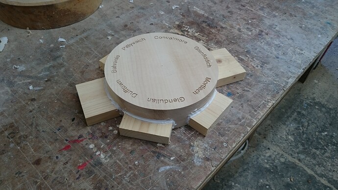

Hi I am trying to engrave writing around a bowl rim, any ideas how this is done? Do I need pro to achieve this. Thanks kas
No need for pro edition if its just simple text, i find it easier doing the text before i turn the inside of the bowl so that you can set the z height in the centre of the bowl, hope this helps
The way to curve the text is by using the Circular Text Utility in the Apps section of Easel.
First pick the font and size of the text and create a text message. Select that and go to Apps (the lego brick icon on the left tool bar). The App Library will pop up and you then click on Utilities. Next click on the Circular Text utility and this will let you curve the text using the controls. When you have what you want, export the result and this will go back to your project.
