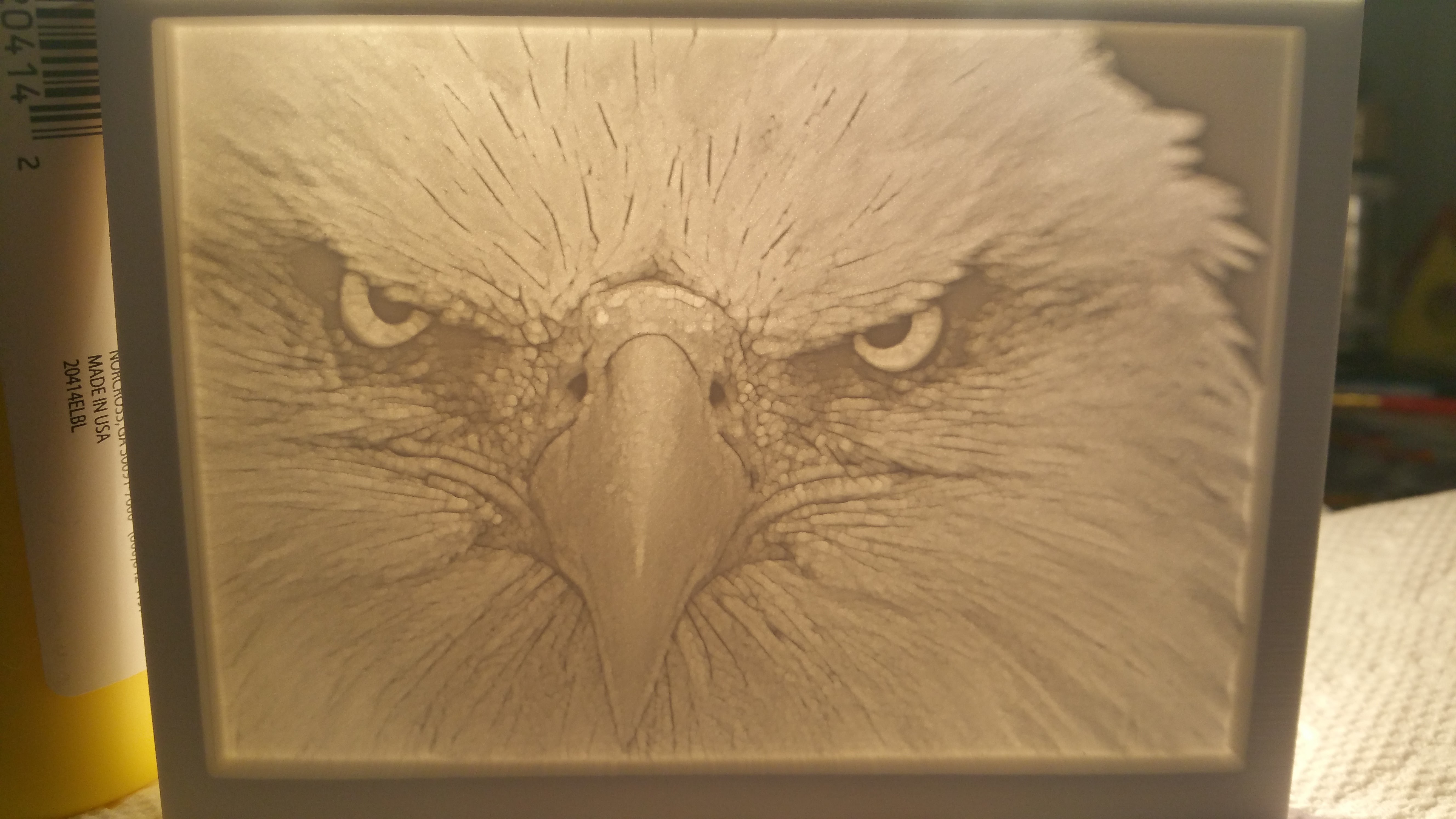

Has anyone used an X-carve to create a lithophane?

@ErikJenkins: I bought some sheets of the candlestone as per your suggestion and I love the material! It carves well with engraving bits and the surface I end up with is very smooth. I will definitely use more of it in future projects! I might even try to carve a lithophane.

@ErikJenkins: What software did you use to create the lithophanes? This surely wasn’t Easel. Can it be done with V-Carve Pro?
Not %100 but I think you need Aspire or PhotoVcarve. An alternate solution is PicEngrave Pro. Thats what I have/use. You mostly hear about it on the forums as software for lasers but it does lithophanes as well. Worth looking at for the price. http://www.picengrave.com/
A lithophane is just a carving thin enough that light can go through.
The extra depth of the material blocks more light.
I believe this is Translucency (Transparency and translucency - Wikipedia)
sounds like you have your answer. buy some soap-stone and start carving.
There are great products that can create lithophanes…Aspire and PicEngrave Pro work very well (I have used these). Just make sure whatever you use to create the lithophane that the model created is setup so dark areas are the higher/thicker spots and the lighter areas are the lowest/thinest. Pretty much anything that can take a photo to an STL will work.
