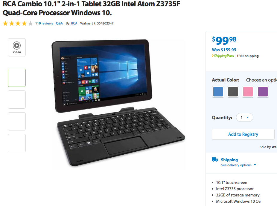

I understand it’s not really what you’re looking for, but your best option (IMO) would be a cheap Window 10 tablet. They are cheap and you can use RDP/TeamViewer/whatever if you want to remote control a more powerful machine.
Something like this:
Or… there are even cheaper options without a keyboard.
