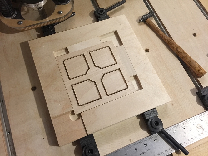

I made a few of these jigs for some parts I make allot of. Material holds with two wedges that push and secure the material into the corner. I am able to quickly change out my finished part, put in another piece of stock, and move the machine back to the starting position. This jig has saved so much time.
IMG_4265IMG_4266
Very nice. Im guessing you use g codes to move the machine back to access your parts?
I use easel for everything I do. I just jog the machine out of the way in 1" increments, change, and move it back. I do have to zero the bit to the material.
I made the jig. very simple, even added it to the projects folder for others to modify as they see fit.
