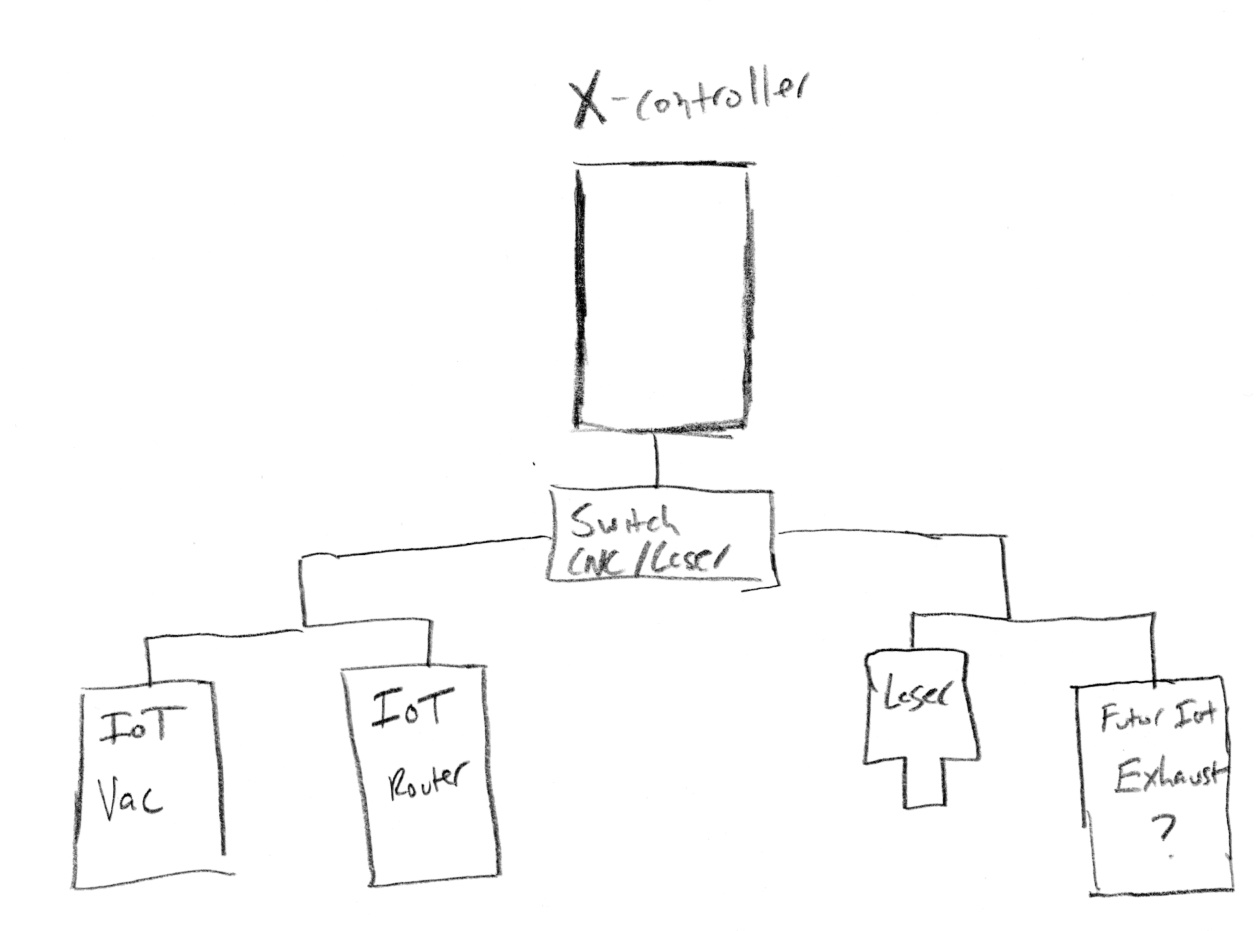

Sorry, to reply to this so long later. Out of curiosity, if using two IoT (one to control the router and one to control a shop vac) is there anything special I should to (Like with the laser switch) to connect two of them to run together or do I just connect the X-controller, Vac, and Router with wire nuts and call it a day?
This is kind of what I was thinking. Thanks in advance for the help. I am wanting to improve my processes a bit over the next few weeks to get ready for Christmas.
Theoretically, that could work for the spindle side, depending on the input characteristics of the IoT relay control pin. Since you are going to use full on and full off the spindle side can act like an on/off switch.
It would not work on the laser side as you will be modifying the intensity of the laser with the control signal which would have the relay bouncing on and off.
If you have some understanding of electronics you could use some external circuitry to accomplish the functional aspect of the drawing on the laser side and the spindle side if the input pin characteristics don’t allow a direct connection.
It might be easier to use the Coolant and Mist pins if you have the ability to modify your CAM program/or post processor without the need for hardware changes.
