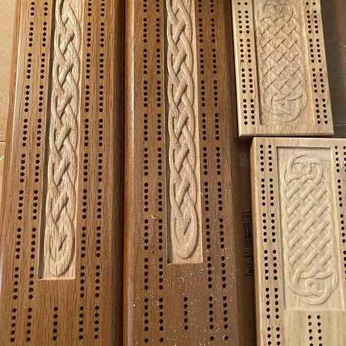

I am considering buying this machine. I am curious if it has the capabilities to carve relief engravings, such as rounded ropes and braids, like the attached pic.
it sure can both models can
I come from a fabrication background, where the CNC program was an exported solid file. I have little artistic ability. What software creates these contours? Does Easel do this?
oh, no
Homepage | Vectric
this will vcarve pro rope
Easel cannot generate 3d relief toolpaths.
Perspnaly I use carveco, but it can also be done with Fusion360 and vetric software. These are the top 3 at the moment.
I just now noticed that I can’t connect my xcarve pro to a GFI circuit and need to ask what the power amp breaker surge protection is needed and recommended. My garage has GFI protection. I may consider running a dedicated fused circuit. Is this necessary?
Which carveco are you using?
Oh , i just replied yo your post, but I use Carveco Maker. :+1:
Youd need maker plus to desig in 3d, but plain maker works great with existing 3d models including .stl files
