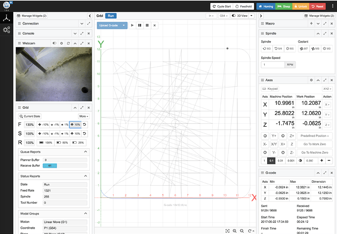

I need to post an updated video, but take a look at these:
I run my CNC with a Raspberry Pi connected to it. then go inside to spend time with family while I monitor things remotely.
