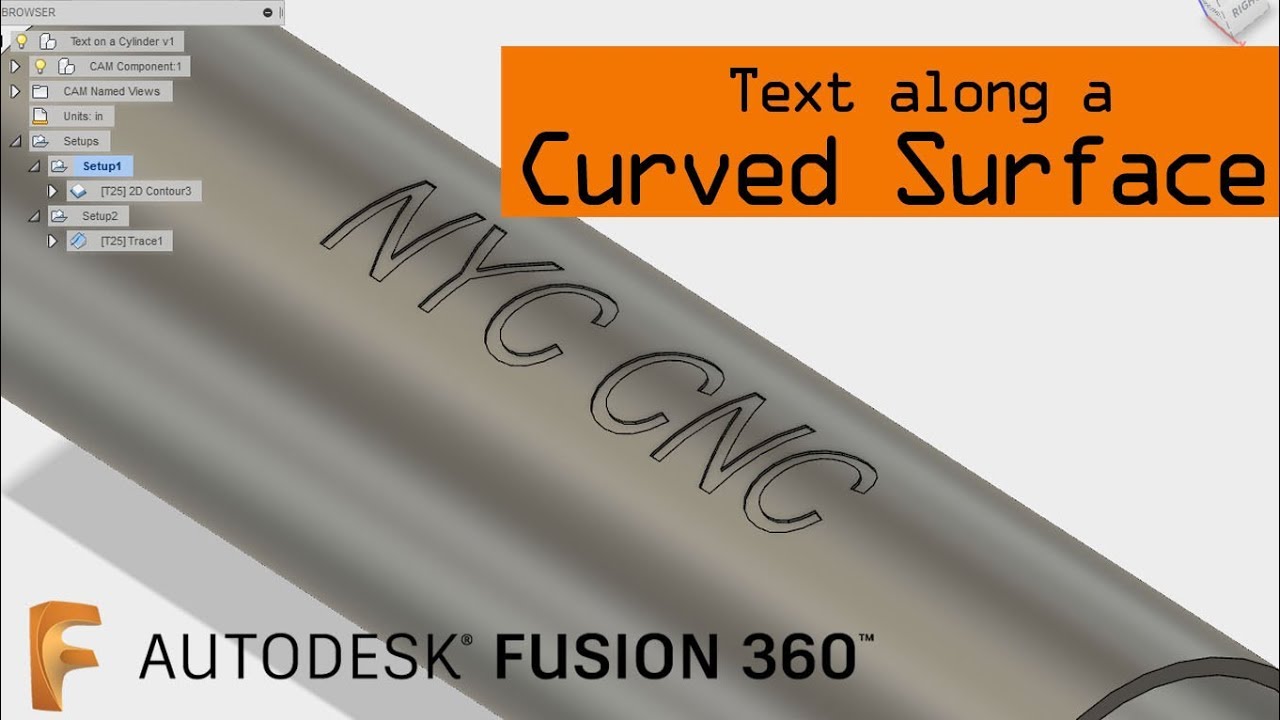

For best results you would want to properly model the curved surface as a 3d model. With Fusion360 for example. And then you can apply the design onto the curvature and engrave accounting for the contour of your new 3d model. There is a machining module within Fusion360 to do the toolpaths and save the gcode to be sent with your desired gcode sender (even easel if you prefer)
there are a LOT of tutorial vidoes for fusion360 and there are a handful about adding designs onto a contoured shape, but this one from NYCNC is a good place to start, I do suggest checking out a handful of fusion360 videos if you haven’t tried it before as there is quite a steep learning curve.
