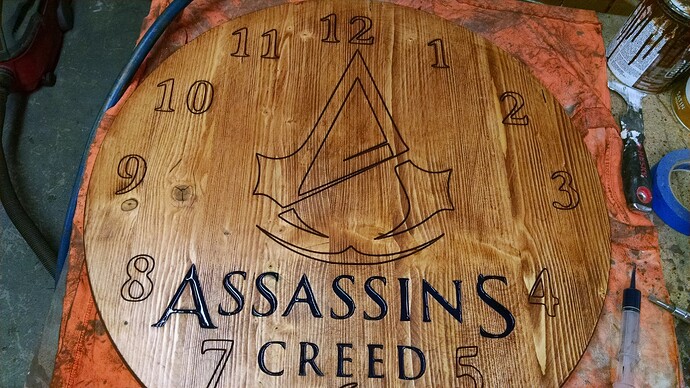

Love the clocks! How do you get the black in the lettering? thanks
Cut the numbers to 0.1 inch this is perfect to fill, use water base gloss paint and thin it to the viscosity of maybe buttermilk.get the syringes from an art and craft store and inject into #s and lettering.
If you are referring to mine. They are filled with pigmented (black) resin.
