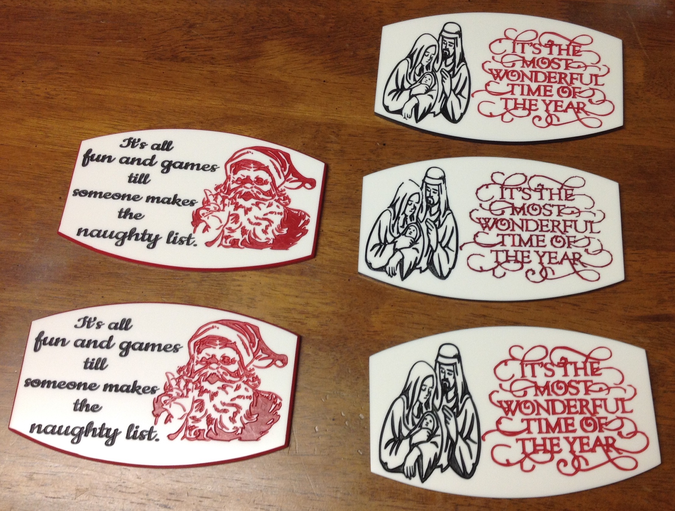

A few family gifts inspired by @ErikJenkins and made possible by @CharleyThomas three axis zero probe.
Material 1/4" white Corian
Two tool paths 1.25" 90 Degree V bit for text and images and a 1/8" down compression end mill for profile
Developed in V-Carve Pro 9.0
UGS
Marsh stencil ink for four and craft paint for right middle one all coated with matte acrylic sealer
