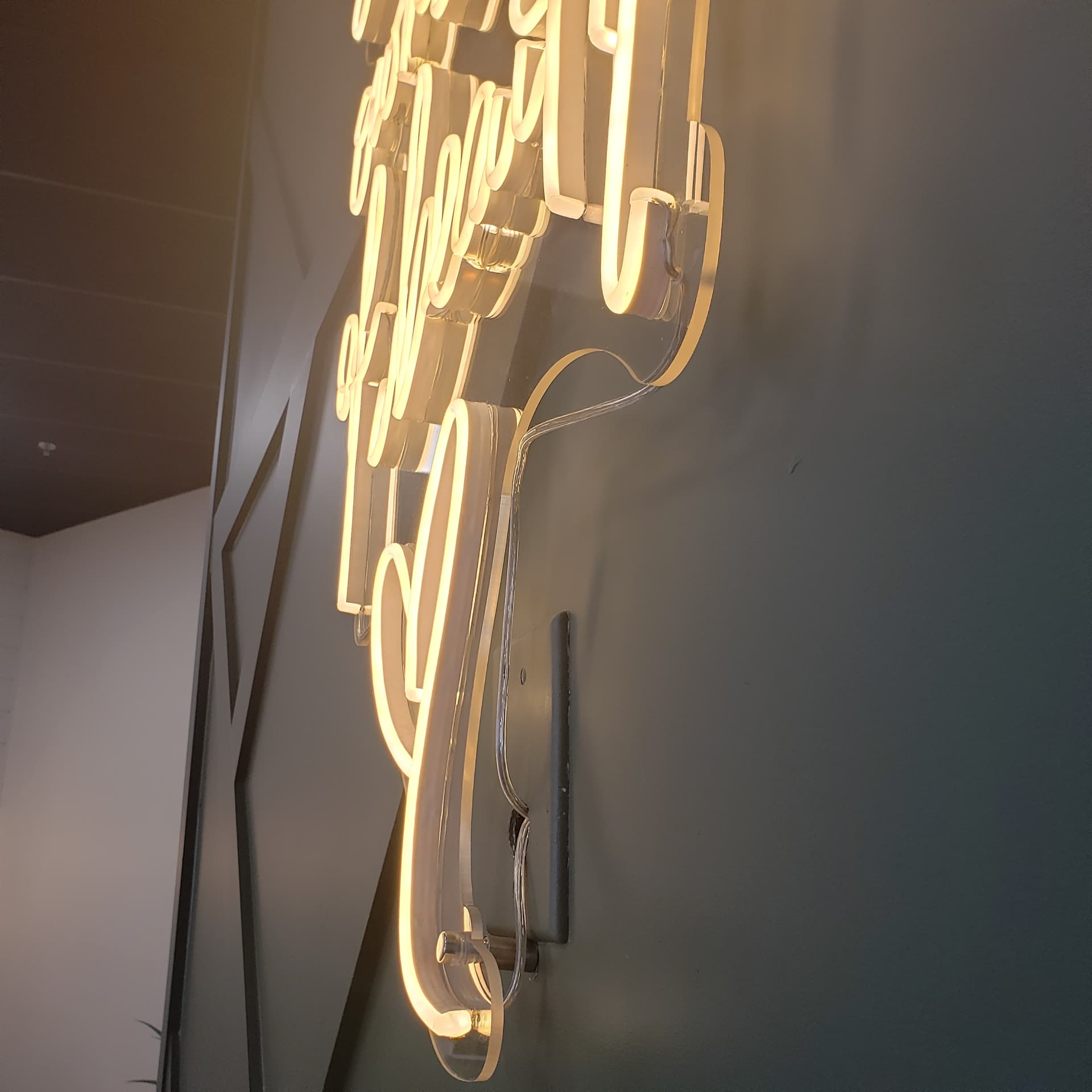

I’ve seen these signs made 2 ways, one with the grooves you’ve mentioned and another without the grooves at all.
If I were to make any of these signs I would skip the groove, it would make cutting the LED more forgiving to over or under cutting, it would drastically decrease cnc machine time, and it would make more acrylic reusable if there was an issue with cnc operation.
Here’s an example of the led affixed to the front, flat, non -grooved surface for your reference
Now to answer your question, easel does not have centerline fonts in the font library. You could use a 3rd party program like inkscape which has access to all downloaded fonts and you could download a centerline font from a font website.
