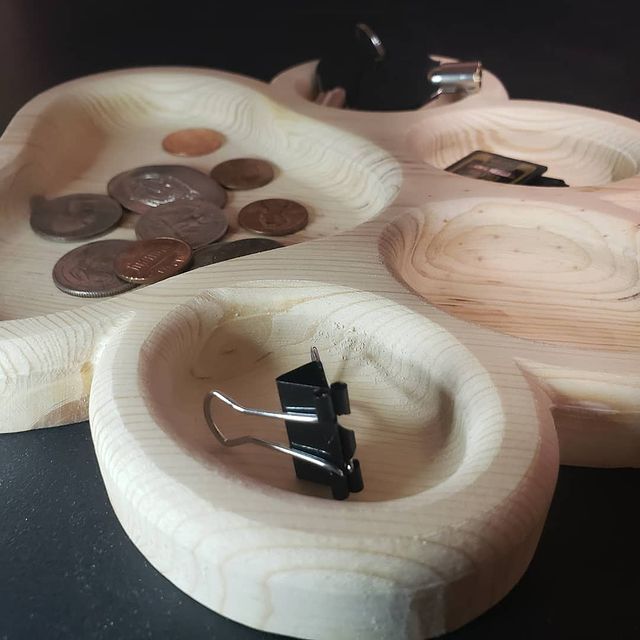

I am totally new to CNC routers and I’m looking for some direction. The image is not mine, it’s just here for visual reference. I’m looking to carve an EDC/Dump Tray with multiple segments. I want the edges in the bottom of each segment to be curved like the example and not squared off. Any help would be outstanding!
Hi Mark, welcome to the forum!
A bowl / Tray Bit would be preferred for this in order to get both a flat bottom and a radiused bottom edge.
You could do it with a Box Core Bit but you’d have to setup the stepovers and stepdowns and finishing toolpath and that’s not the easiest to explain using easel.
A Bowl/Tray Bit was used in the making of this tray
