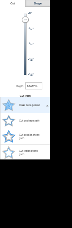

my project will not combine the cuts. not sure why this is not working anymore but when i try to combine the words with a circle it just shows the circle

here is my project i cannot combine the text to the circle.
for some reason i was able to combine the dot above the I but not the text to outer ring.
Set the 2 circles to fill, then set the inside circle depth to zero and the outside circle to a depth greater than zero, then you can select everything and combine

I don’t have an option to set to fill. Do I need easel pro to have that option?
No you dont need Easel Pro, I’m sorry Clear out a pocket is the correct term, the first one on the Cut Path tab
Thank you, That worked! Seems like its a way harder process than I have done before.
