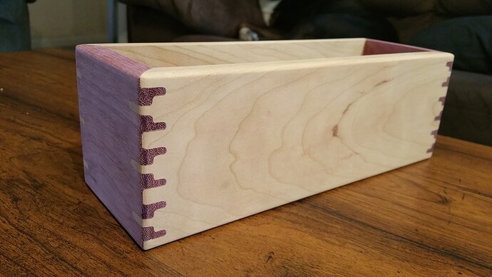

I love what you did with this box! What program did you use to run the Gcode?
Thanks! The G-Code was generated with the Tailmaker program and sent to the X-Carve with Universal G-Code Sender.
Thanks for the info. Did the .tap plug in directly into UGS, or did you have to edit lines?
I edited the header, I took a header from a V-Carve generated G-Code and just pasted that to the beginning. If you go this route, make sure you know what commands you are pasting

The link @SethCNC posted is the program I used. I downloaded from this link just now and it runs and seems to be the same version I bought several years ago, but now it is free.
