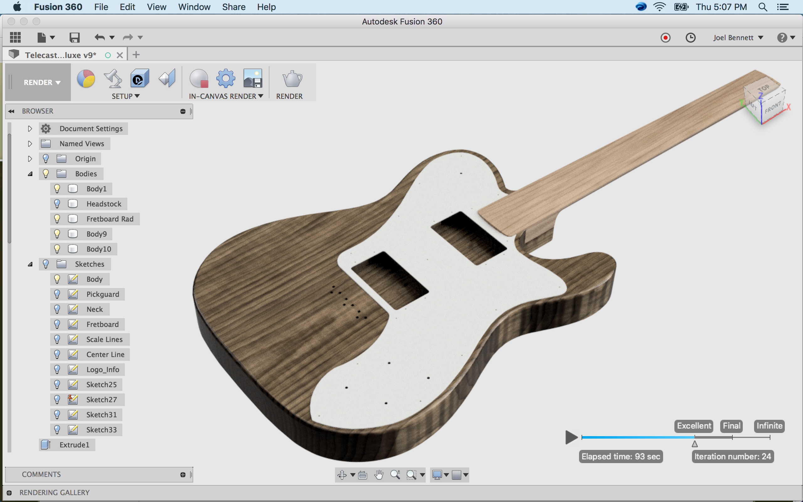

I’m just making some guitar models in Fusion while I’m sitting around, gonna start building some with my machine soon.
Telecasters are a great place to start since they’re such a simple body design. I have plenty of templates on my website (in the guitar templates section in the top menu) that you can use to get the outlines from, but I’ve only just started making full three-dimensional models so I can move into making guitar kits for people next.
If you want the template files that I keep for myself, I could send you them since they’re a little more organized and geared toward CNC work.
I can’t find the free 3d files section on there, only the ones for sale - can you link me directly?
Welp, your Les Paul body was 439" long, which is slightly larger than the original. The Tele came in at a more reasonable 403" in length.
This is measuring both DXF and STL files (the STL for the LP was 168", which is even stranger).
// Conversion corrected - see below :poop:
439mm is 17.2835 inches…might want to convert :slight_smile:
