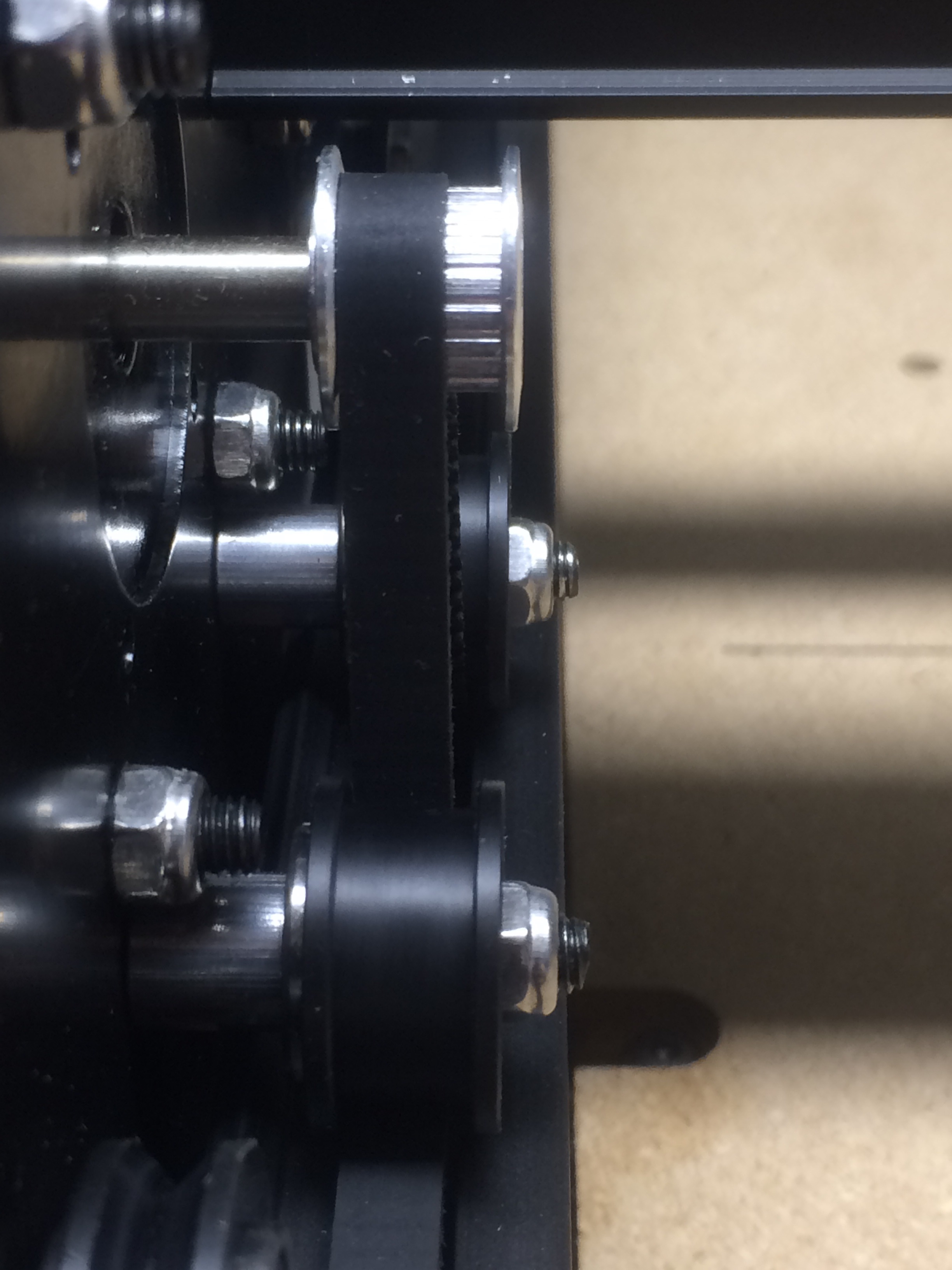

I assembled my 1000mm XCarve and noticed the left Y belt rubs on the left side of both idlers and drive pulley. The idlers and pulley are all in line with one-another. I don’t see any adjustments on either end of the belt that would allow me to move the belt to the left or right to center the belt on the idlers/pulley. Am I missing something? Is it possible my Y axis stepper motor is toeing in or out causing the belt to ride on one side of the pulley?

I looked over the assembly pictures again and went and compared my idlers, they are installed correctly.
After twisting the front belt clamp on the left Y rail a little, the belt now stays centered when moving the gantry from far front to half way to the back. From half way back to far back the belt moves quickly to the left of the idlers and pulley.

They changed the idler configuration for the new Xcarve (picture from the new Instructions)
Have you tried sliding the belt on the motor pulley out towards the center? The idlers look fine, it’s the position on the motor pulley that looks off and should be able to slide and adjust it. If the belt is straight, it shouldn’t move.
I appreciate all input. I did slide the belt to center. That made an improvement as the belt stays centered for half of the Y movement (front to halfway back). From the halfway point to far back the belt move quickly against the left side of the pulley.
I suspected during the build that the belt wasn’t cut straight. I’m going to order a new belt, if anything I’ll have a spare on hand.

If you’re feeling adventurous, flip the belt 180 degrees so what was the back half is now the front half, and see if the problem changes to be fine on the back and slide to the left at the front. That should clearly indicate a belt issue.
Good idea - I already bought the belt. I can’t contact customer service until I get home from work. I will flip the belt but I think the belt cut is off and the teeth aren’t perpendicular to the belt edge. I think the teeth are getting seated in the pulley and driving the belt into the side.
