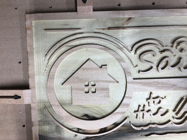

Bad cuts. What’s the cause? Help please

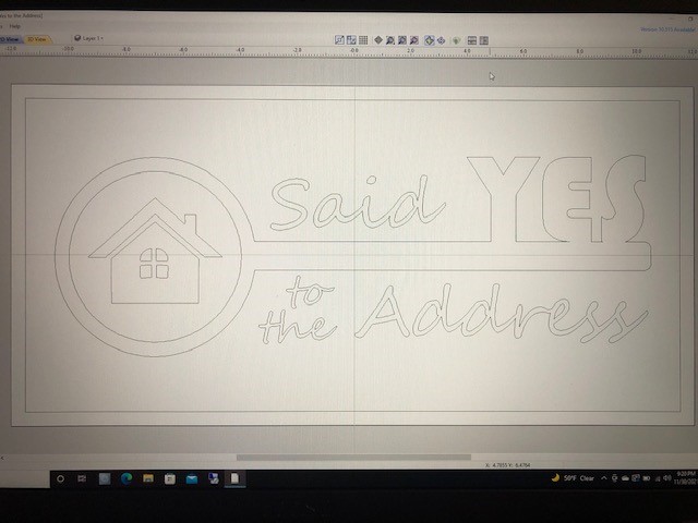

I made my first cut the other day and it came out great. Tried to do something a little more complex and the cut came out horrible. I’m cutting in plywood. The attached pictures show my design, how the cut turned out, and the spindle/bit settings. Can somebody tell me how this happened and how to prevent it from happening again? Was my feed too fast? Do I maybe have some screws loose? Any thoughts would help.

Personally I wouldn’t run a stepover higher than 45% … because then the wood is engaging the trailing side of the bit.
That and its a fairly standard practice to run 0.5 times bit diameter = depth per pass and your going a bit further than that.
What does the vcarve simulation look like?
And 175 in/min to boot.
The carve being in plywood does not help either.
Looks like it missed steps.
