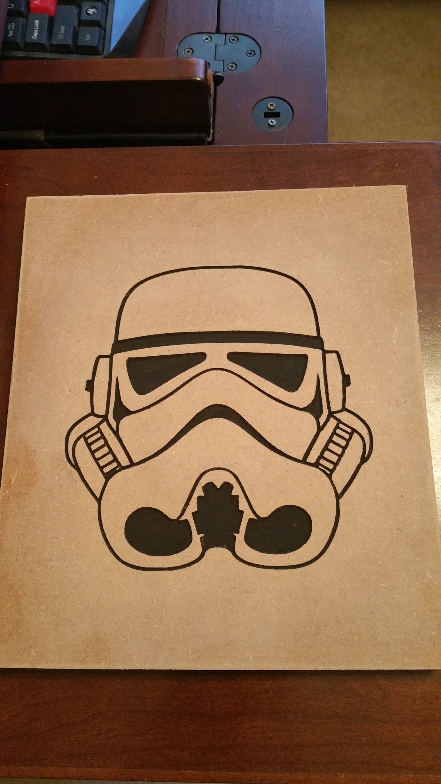

When I use MDF, after I cut I put two coats of this on to seal it. Works well to keep the paint from bleeding.
http://www.amazon.com/gp/product/B000GPNKTC?psc=1&redirect=true&ref_=oh_aui_detailpage_o01_s00
I used Vcarve, with a .125 endmill to cut the profile and a 6mm endmill for the pockets. But there is no reason that Easel could not do the same thing. Here is the SVG I exported from Vcarve.
This was sealed with two coats of the glue, the black was painted with a brush…then a quick sanding to get the excess off. There is no bleeding and the lines are nice and crisp.
@ErikJenkins what if you needed color instead of bare wood as your background as the OP?
I am actually going to be adding white to this one. I will sand one more time (get rid of the dirty fingerprints on the left side) re-seal the MDF with a couple of coats of polyurethane then a couple of quick coats of white. With the polyurethane I should be able to brush on the paint and use a cotton swab to remove any white I get in the carved areas. I will just have to be careful.
I have experimented with BIN Shellac Based Primer and had decent success as a primer / sealer on a recent project. The Glue sealer is on my list of test procedures as well.
I like the glue sealer, I have been using it for a few years on MDF. The stuff I use is sold as a jigsaw puzzle sealer for finishing puzzles to hang.
I ordered Gallon size from S&S Int. with your recommendation as soon as I read your post. That’s always I’m after. Doing job is no problem, my problem starts when I’m finishing. Crab, I waste hours and hours job sometimes. If this glue doesn’t work, I’ll hire some one to do it.
I hope it works as well for you as it does for me
I know you said you had problems with the paint soaking in. I know when I have used MDF before it does really well with acrylic paint.
I think you are correct, others have also told me acrylic paint does much better. Next time I will try that.
