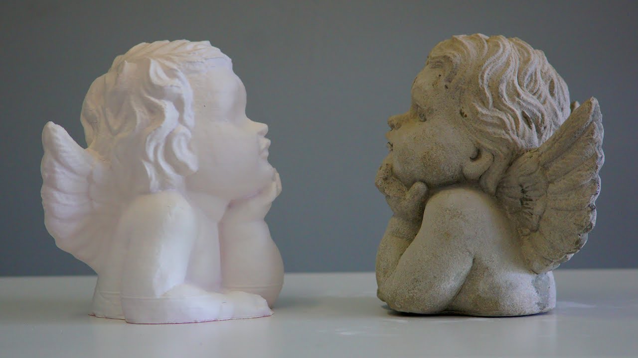

However… I’ve found modern ‘Photogrammetry’ software does a much better job. Using a phone/camera and something like Autodesk’s ReMake will create higher detail 3D objects than any version of the Kinect.
Here is a good example of how ReMake works…

I did this just now. The shape is there, but the finer detail isn’t. Not bad imo for a $15 investment. For what I’ll use it for it should be fine.
