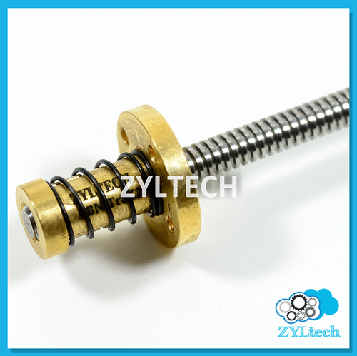

The Z axis acme lead nut is a weak link for doing lots of precise engravings IMO. Does anyone know of an anti-backlash nut source - one that will fit Shapeoko 2 / X-Carve?

Openbuilds has one, looking at the design it should have the same size (M5) and spaced (20mm) mount holes.

That seems to be a 4-start thread. I’ll have to check if I have that or a single start screw.

Maybe if you added a second Delrin nut attached little lower to the z axis? Setting the tension would be tricky though.
Or even just a second Delrin nut on the ACME rod (maybe not even not connected to anything) with a tensioning spring (slid around the rod) in-between them?
Would that work? That seems to be how the anti-backlash nuts on my old MaxNC work.

Thanks, I may have to go that way, but it seems more involved than a simple “bolt-on” solution I had hoped to find.

Looks like there are not too many options. It certainly is a weak spot IMO that needs a fix. Might be possible to modify the existing nut to more like the Open-Builds design. I will look into it.

Take two nuts and a shaft and squeeze them together.
Sorry, couldn’t resist.
After you get it set drill and pin it with a small roll pin
