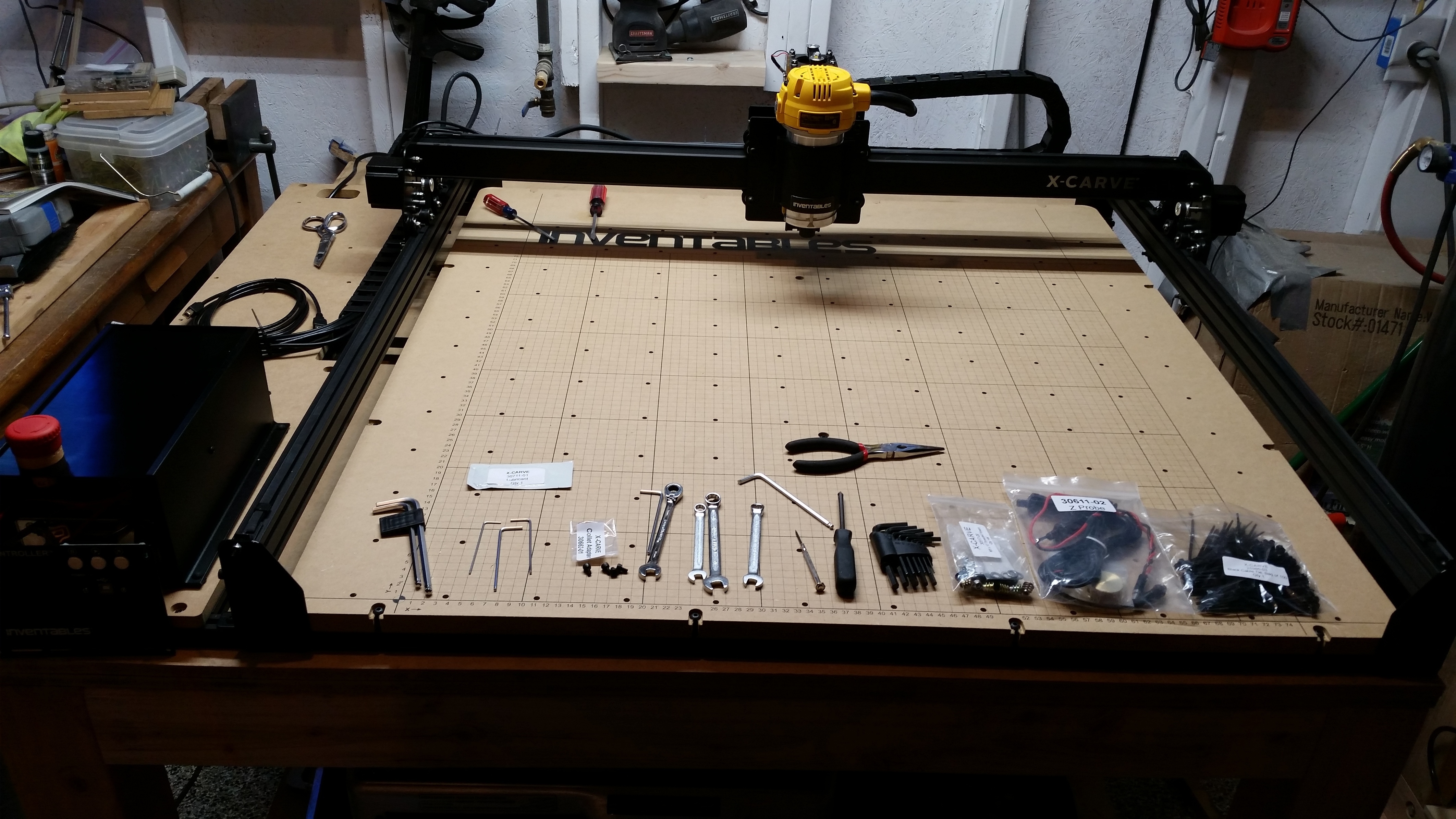

So, following the instructions on the website, I have my system built…ish.  a few things bother me. How do you know when you have the tension set on the belts right?
How do you set the dip switches/potentiometers for the upgraded stepper motors?
These are the ribbon cables I got. Now with my computer background, those cables are set with the pins in a certain way. Having to flip one side, will that cause problems?
How do I set up the zprobe part? Didn’t see anything about it…
Are there any other things to check/watch out for before plugging it in and giving it a test? (This is my first anything like this, so I apologize for the ignorance.) Thanks in advance.

              Look in the “prepare controller board” section here.  If you have a multimeter the easiest way to set the pots is to measure at the voltage test points as explained in the instructions.  I believe the default stepping value for the X and Y axis is 1/8 and the Z is 1/2 (you can see this if you zoom in on the picture in the instructions).

              There is an additional technique for the Y belts if you have a musical ear - after you’ve set the tension with the fish scale, as a final check move the gantry all the way forward (so you can adjust from the rear) and pluck the belts and adjust until they have the same note as each other.  That way you’re pretty sure they are at least the same tension as each other.

              Once the tension is set with the fish scale technique you’re not plucking the belts for a specific note, you’re plucking them to match each other.  You could actually use the fish scale for one, then use the pluck for the other.  The theory is that if the belts are matched in tension/stretch you are minimizing any teeth/inch difference between them.

              The potentiometers on the X-Controller are set for the NEMA 23’s we ship with.  You don’t need to adjust them unless you are using different stepper motors with different tech specs.
The potentiometers on the controller board allow you to control the maximum current to the motors. Clockwise increases the current and counter-clockwise decreases the current. Current ratings are different for NEMA 17 (1.6A) and NEMA 23 (2.8A) stepper motors and need to be set accordingly. The slot between the dots on the gray actuator is the pointer, and can be adjusted based on the diagram on the controller board.
For those users who would like to know the current more precisely, you can measure the amount of voltage on the reference and ground test points. Use the formula on the diagram to determine the current. For example, if you measure 1V you get 2.13 amps.
