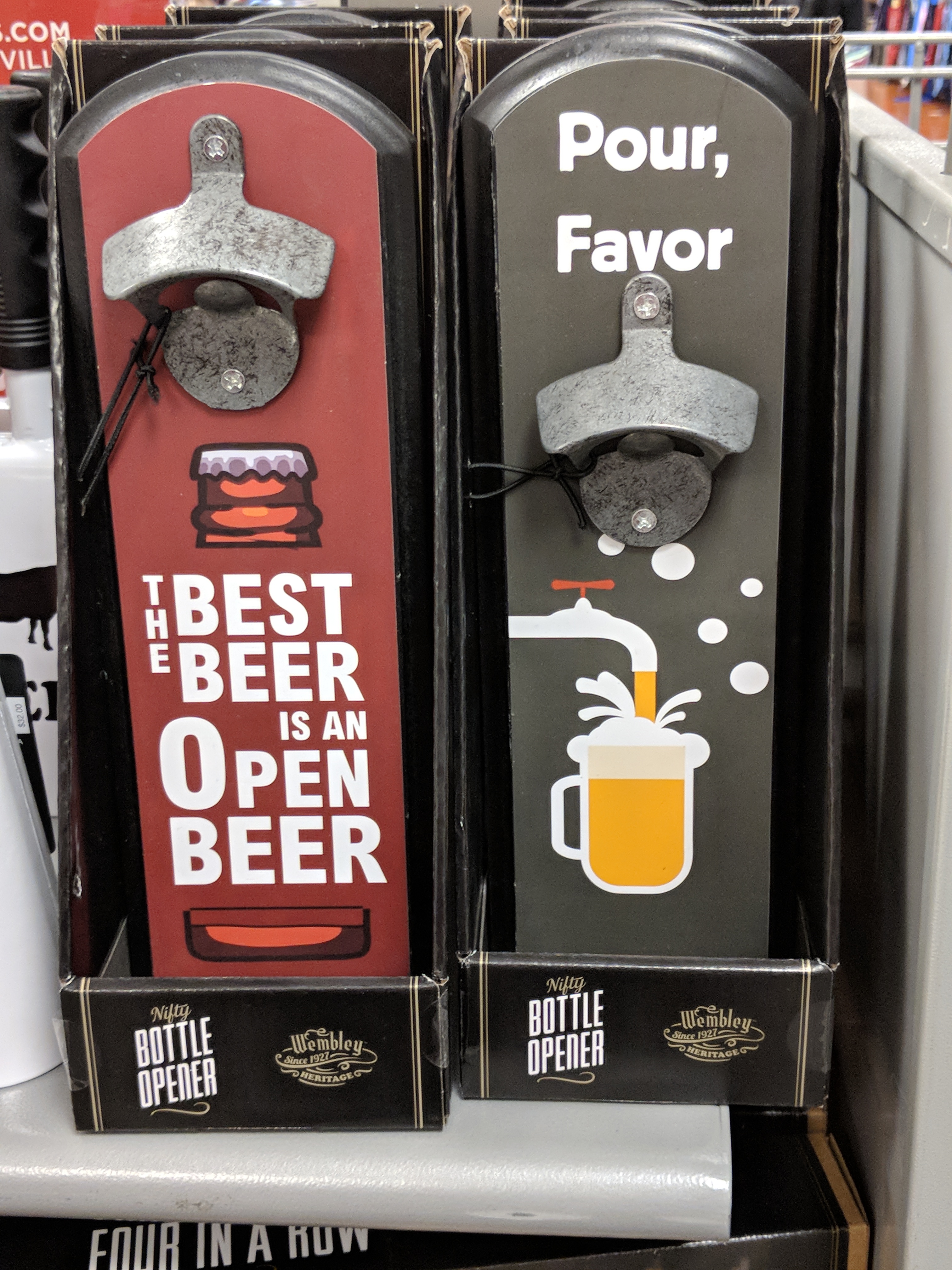

Saw these last night at Kohl’s selling for $32.99 ea. They have it sitting in a small metal box to catch the tops.
did you notice how those were to be hung?
I did not. But I might swing by there later after work and see what I can see. Stay tuned…
