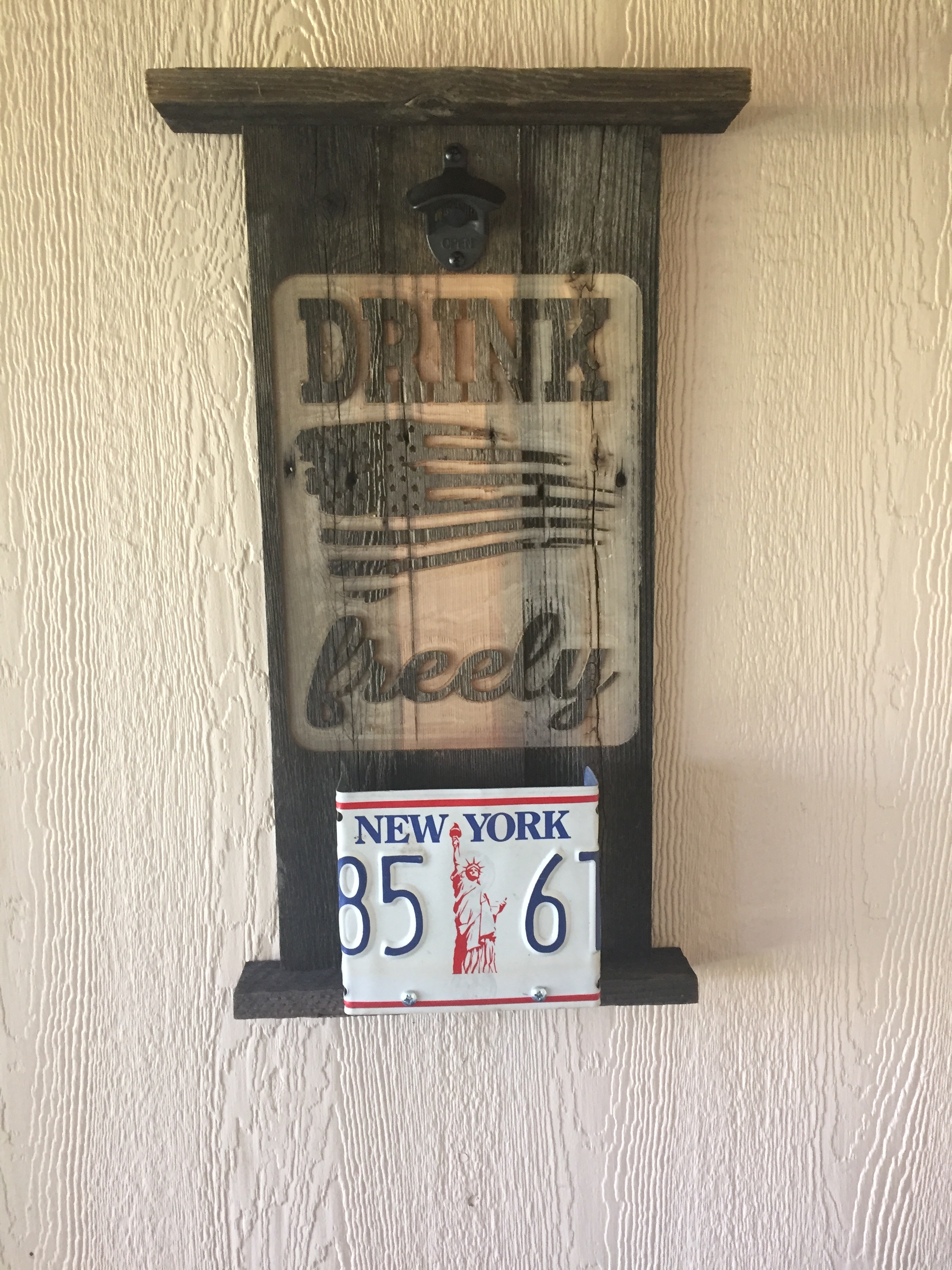

I love making bottle openers too! Here are a few of the ones I’ve made for family and friends!
the license plate catchers are a nice touch

Anyone use magnets on the back to catch the bottle cap? I’d rather do that than use a little catch box on the bottom. I can’t find a magnet strong enough, ordered some rare earth discs and have 2 glued in. Hopefully that works, waiting on the glue to dry now.
Any old computer hard drives laying around? Those magnets inside them are the strongest thing I have ever played with! I hold heavy things to metal shelving in my garage and have used a couple as fridge magnets for heavy things on the side of the fridge
I’ve been looking into that as well. N52 magnets seem to be the most commonly used, but they’re about $10 each for a decent size
@NicShimala that’s the type I have. I paid $8 for 6 that are 1.26" diameter and 1/8" thick. Ended up just using two of them and it works. One magnet just wasn’t catching them, and thicker magnets make the overall cost more. Using two of the thin magnets keeps overall cost low for me, so I’ll just do that.
Think that will work? How much face material did you leave after recessing the magnets in the back?
I think I left about .4" between the face and the magnet. It was just the first test with these new magnets. I’m going to probably leave about .2" on the next one I’m making for a friend.
