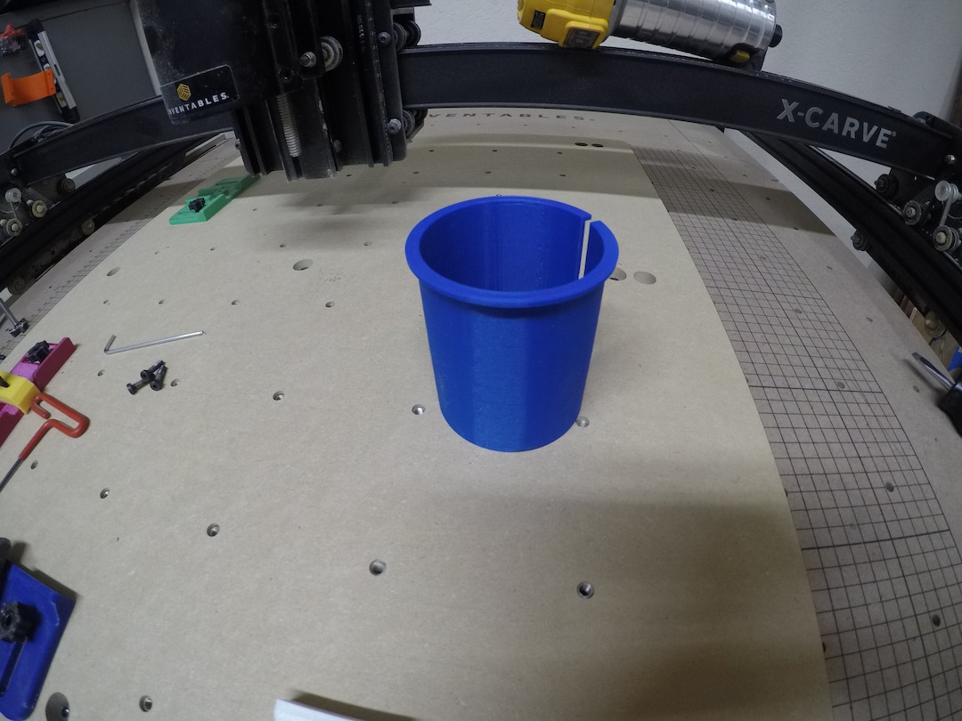

Makita RT0701 (need shimming as its about 1/8" slimmer. A couple of pop cans worth of shims will get you there
The Makita also have the added benefit of having a lower minimum RPM range (10k) and longer brush life. (replacements are available)

If you use the Makita, there is a guy on Etsy that sells an adapter.
