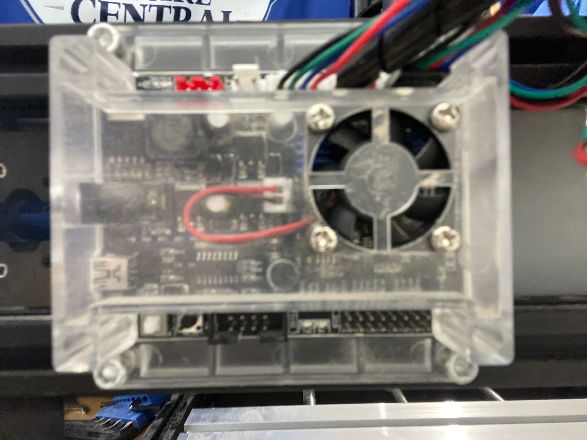

Hello everyone! I need some assistance with my new PSU and 500W Spindle
Here is where I currently stand. I have wired up the spindle and have full control over the speed through the potentiometer and the power is good. The issue is now is that I am not getting any feedback from the control board and can’t move the axis at all through Easel or Candle.

My main pain point is wondering what to connect the 0-10v port to. Does that go to the 24v Power Connector to the board or the Spindle PVM or something completely different? Do I need to get a new control board?

you would need to remove the potentiometer , but you can attach the 0-10v connection to the PWM connection of the 3018 controller board. then the cnc controls the speed by outputting a PWM signal.
You will also want to verify that $30 is set to 12,000 (the new spindle max RPM)

Appreciate the help! I took off the potentiometer got the control board to finally power on properly and just need to test it out tonight.

So I took off the potentiometer and wired up the 1-10v to the Spindle PVM. My only issue now is that I cant get the Z,Y,X axis to jog at all.

When I plug the USB cable from the board to the computer the fan spins up on the board but I get nothing working in Candle or Easel to job the machine. The computer recognizes it, but nothing happens and the machine doesn’t seem to be recognized. Also does not jog with the offline controller (though i never tried to use it before anyway).
The only thing that isn’t reconnected is the male 24v Barrel Plug. Does that need to be connected into anything to get the board moving properly?
Yep, the usb only supplies 5v to the cnc controller chip, but for the steppers to actually move it needs the 24vdc connected still
Small problem…I cut up the old power supply to use those as the new outlet wire and DC connector. Can I wire that control board 24v power into the new power supply somehow?

I am at the same point in 2024 after the 500W/52mm upgrade. I have three boards and they seem to all have a board jumper setting for reverse direction.
What also held me up was the Arduino Uno Stepper Shield has a jumper to enable the board which the other 2 do not have and which I wasn’t expecting. . It’s the jumper pair right next to the reset button (and right next to the jumpers for all 4 axis reversal).
