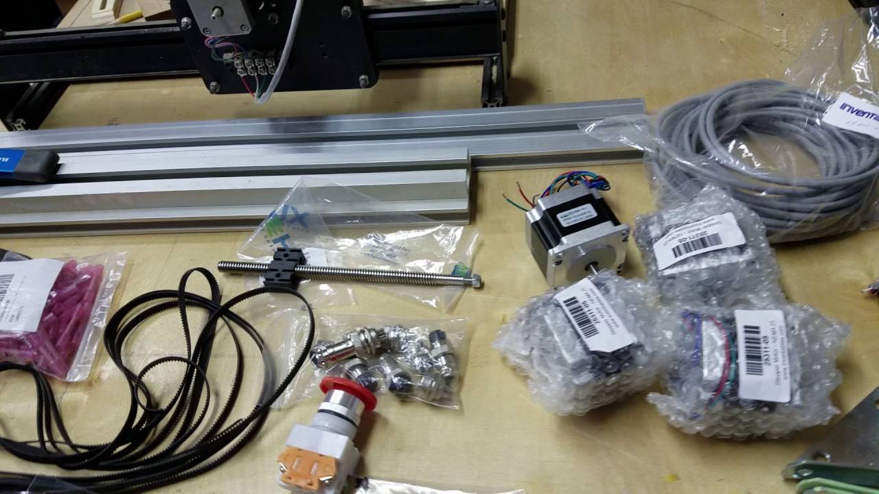

My list of items so far
Aluminum Extrusion (20mm x 20mm) - Black
http://www.inventables.com/technologies/aluminum-extrusion-20mm-x-20mm-black
Description: Length: 958 mm, Width: 20 mm, Height: 20 mm, Color: Black, Finish: Black Anodized, Type: Extrusion
Unit price: $18.63
Quantity: 3
Description: Finish: Black Anodized, Length: 1000 mm, Width: 20 mm, Height: 20 mm, Type: Extrusion, Color: Black
Unit price: $14.00
Quantity: 2
MakerSlide
http://www.inventables.com/technologies/makerslide
Description: Length: 1000mm, Type: MakerSlide, Color: Clear Anodized, Ends: Not Tapped
Unit price: $20.93
Quantity: 4
ACME Lead Screw Kit
Description: ACME lead screw, Delrin nut and hex nut
Unit price: $30.00
Quantity: 1
Button Head Cap Screw
Description: Finish: Black, Length: 10mm, Pitch: 0.8mm, Quantity: 10, Type: Screw, Screw Type: Button Head, Thread Size: M5
Unit price: $2.52
Quantity: 2
Extrusion Bracket (Gusset)
Description: Type: Bracket, Bracket Type: Gusset, Finish: Clear Anodized, Height: 30, Length: 30, Width: 20
Unit price: $1.50
Quantity: 6
Pre-Assembly T-Slot Nuts
http://www.inventables.com/technologies/pre-assembly-t-slot-nuts
Description: Pre-Assembly T-Slot Nuts - 25281-05 (x10)
Unit price: $5.00
Quantity: 2
Stepper Motor - NEMA 23
Description: Motor Type: Stepping Motor, Holding Torque: 140oz-in, Form Factor: NEMA 23, Shaft: Single w/ Flat, Rated V: 2.3v, Current / Phase: 2.8A, Inductance / Phase: 2.2mH, Length: 51mm
Unit price: $39.00
Quantity: 4
Stepper Motor Cable
http://www.inventables.com/technologies/stepper-motor-cable
Description: Length: 1 ft, Category: Accessory, Type: Cable
Unit price: $1.00
Quantity: 36

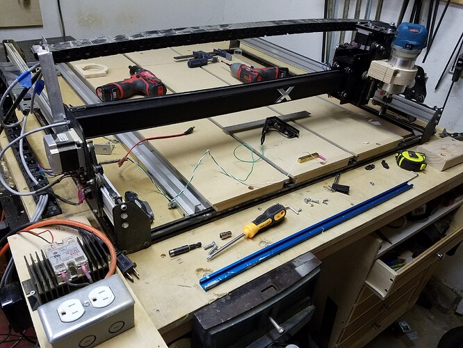

Latest update 8/4:
Progress is slow going as I only get an hour or so in the garage at night when everyone is sleeping. But any progress is good to me! So, got the new parts (pully’s and makerslide) and the frame is together. Now its the details that I’m working on. Routing wires, work area ideas, dust collection… I’m thinking about picking up a fish scale to work on belt tension. I’m close but I’m going to take my time and not rush. Gotta keep those mistakes to a minimum!
Video for those who want to see;

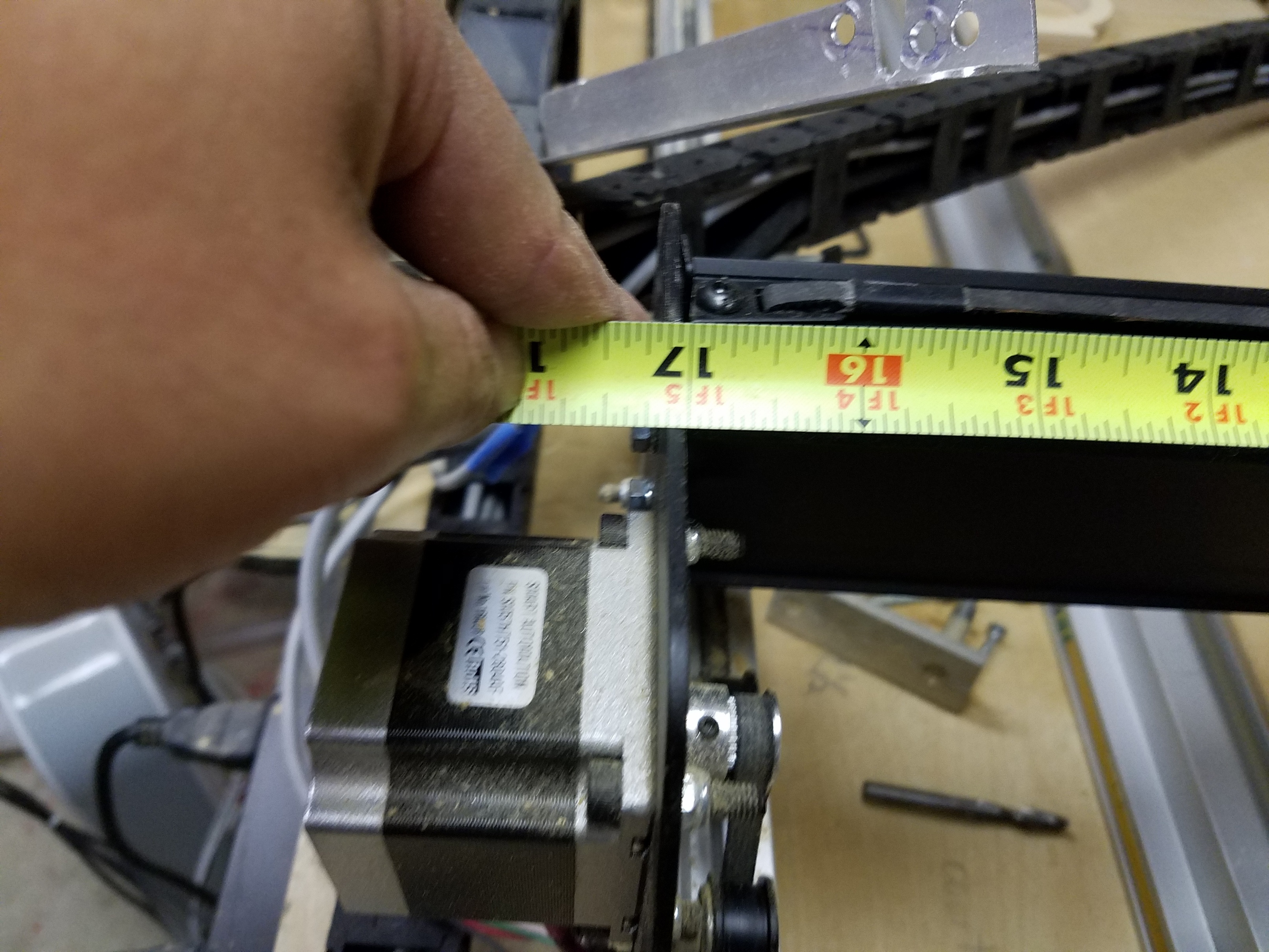

but then I got the new wide maker slide in the mail today so its time to upgrade… but first a quick and crude measurement.

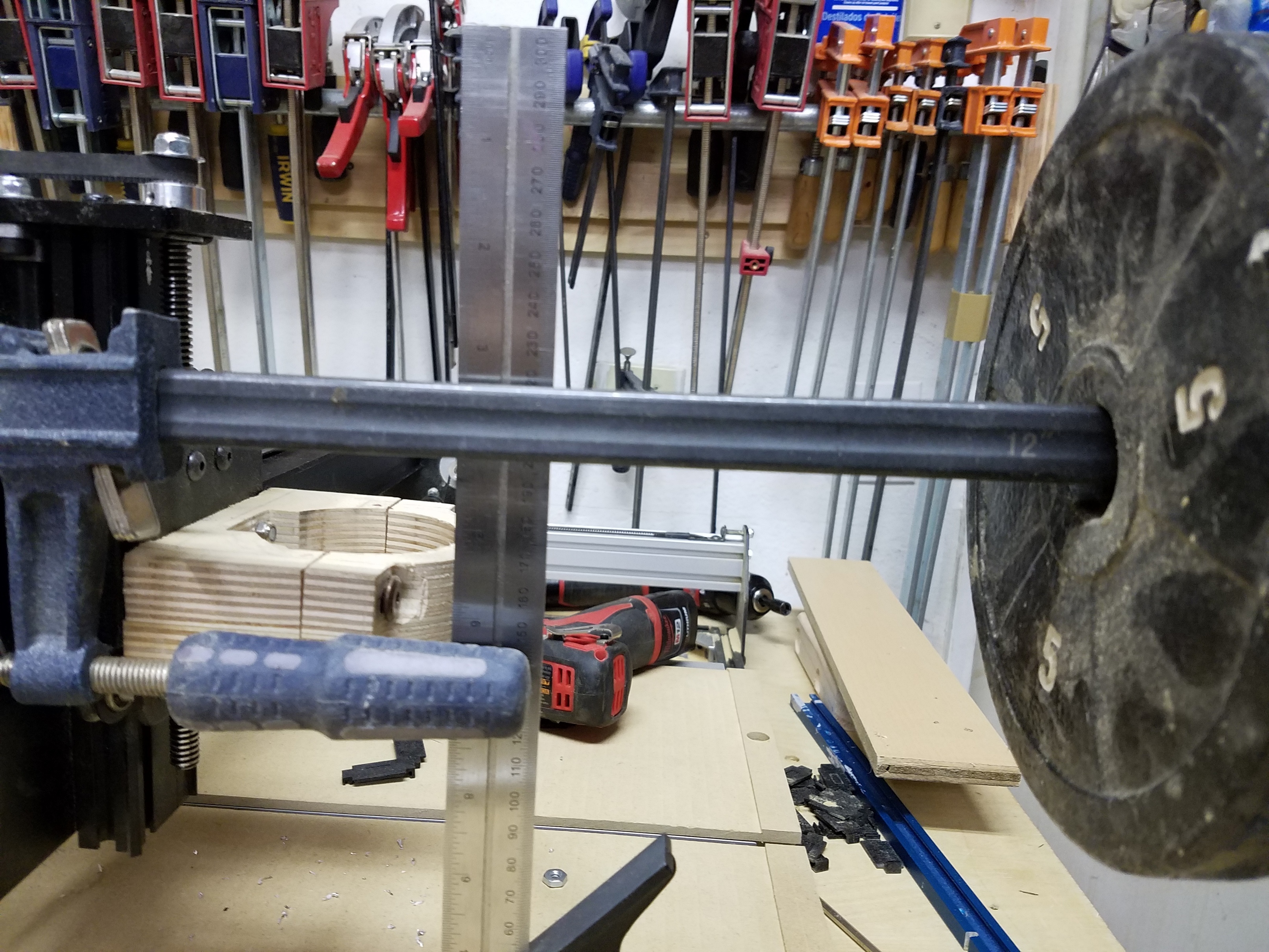

I pulled the slide out 17 inches to the middle and put a 12 inch clamp… and a square up to measure the top of the clamp…
looking at around 220 mm
then I add a 5lb weight to the end. about 3 mm drop
probably not the best way to measure but… it gives me a gage…
to be continued
Next a lazy install of the wide slide… I really should have taken things completely apart… but I only have a few hours… I just pull the two maker slides off.
install was straight forward… just had to line things up and fish some line through the new maker slide… took about 30 mins. I not sure I saved time by just pulling the makerslides ( I hung up a bit with running the wires.)
getting my gage back up… 17 inches in
making sure I’m back at 220mm
Now I add my 5lb weight to the end of the clamp…
looks like a drop of 1mm… Not bad!

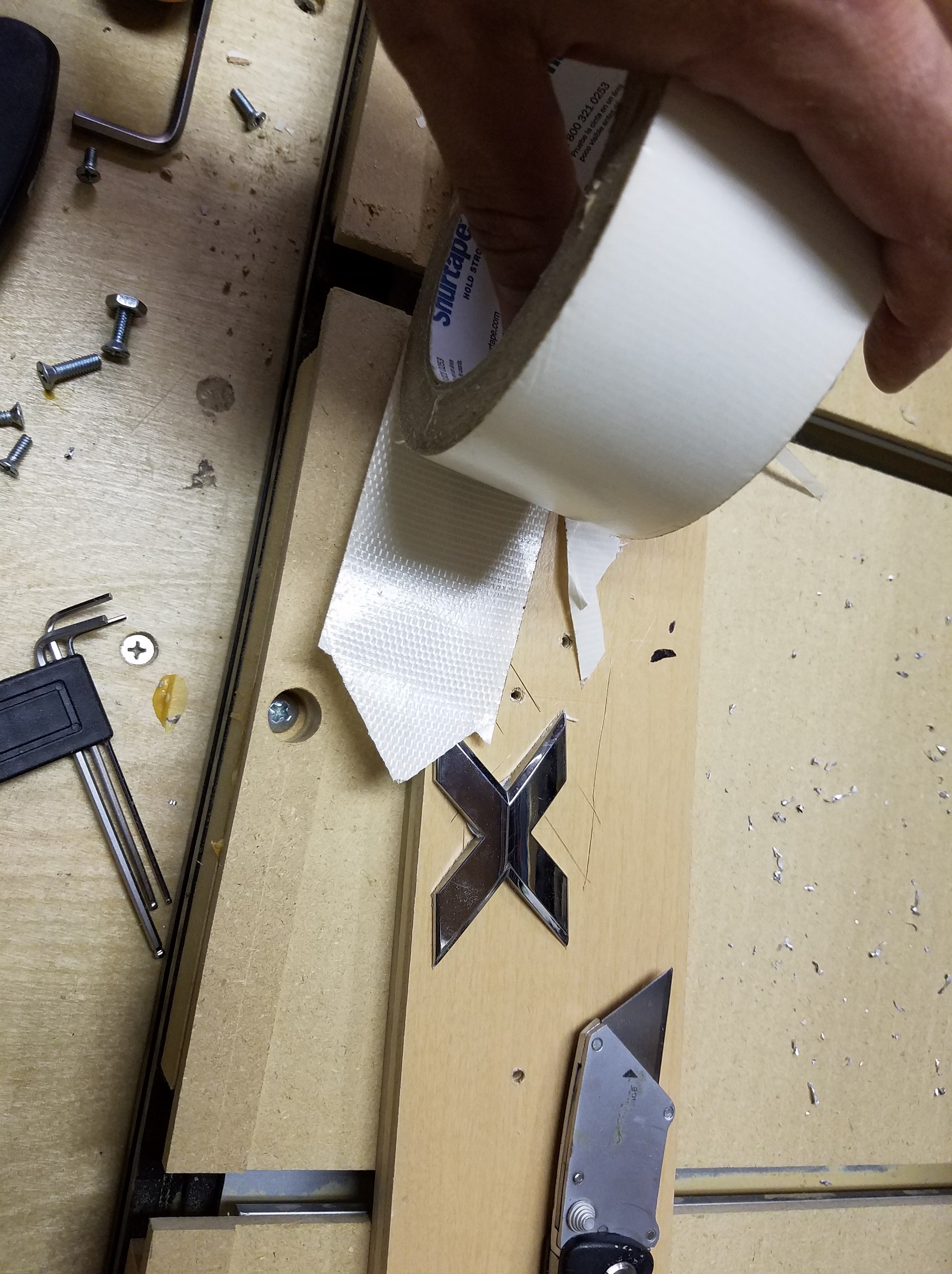

and since I didn’t get a new badge with my wide slide… I had to get creative
Hee hee… X carve
Back together… And running in a few hours.
