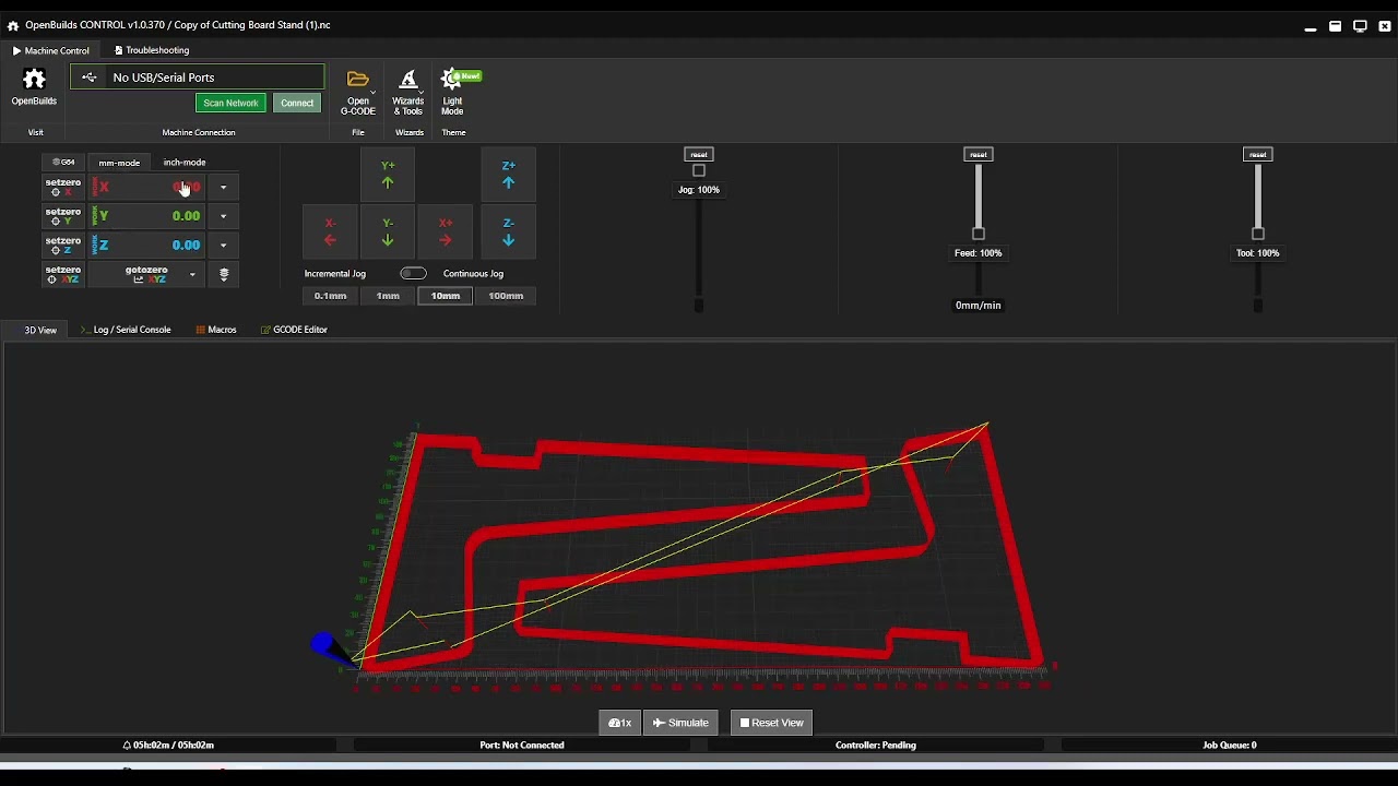

Just thought of something else that I should have lead with : Make sure OpenBuilds Control is not still Connected to the CNC… Even if the window is closed, Openbuilds stays open in the background and will hold the connection. so Click “Disconnect” in OpenBuilds or use Task manager to fully close openbuilds, or restart the PC…
for what It’s worth I love OpenBuilds Control, it has a million times more features than Easel… I can use the XYZ Probe (easel can only use one brand through a proprietary google chrome extension) I can use a XBox game controller to control my cnc (and a phone/tablet) easel cannot… and there’s more I won’t get into today…

So how do you switch from mm to inches in openbuilds cam
Oh, that’s a different issue. OpenBuilds CAM is set for Metric use only. you’d need to convert your inch measurements to mm manually. A conversion chart by the computer, or a calculator and the multiplier of 25.4 are some methods to accomplish that. . . but yeah CAM is millimeters for design only.
HOWEVER you could try BasicCAM which is a spinoff of OpenBuilds CAM from the team at BobsCNC, they used OpenBuilds CAM source code since it’s open source, and made some changes for their customer’s usage and realizing that most of their customers are US based, they introduced a toggle switch at the top bar to switch to Inch mode.
