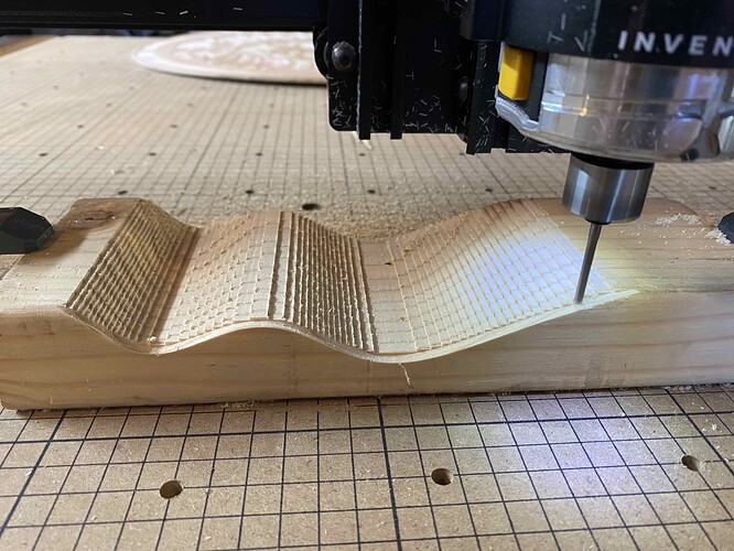

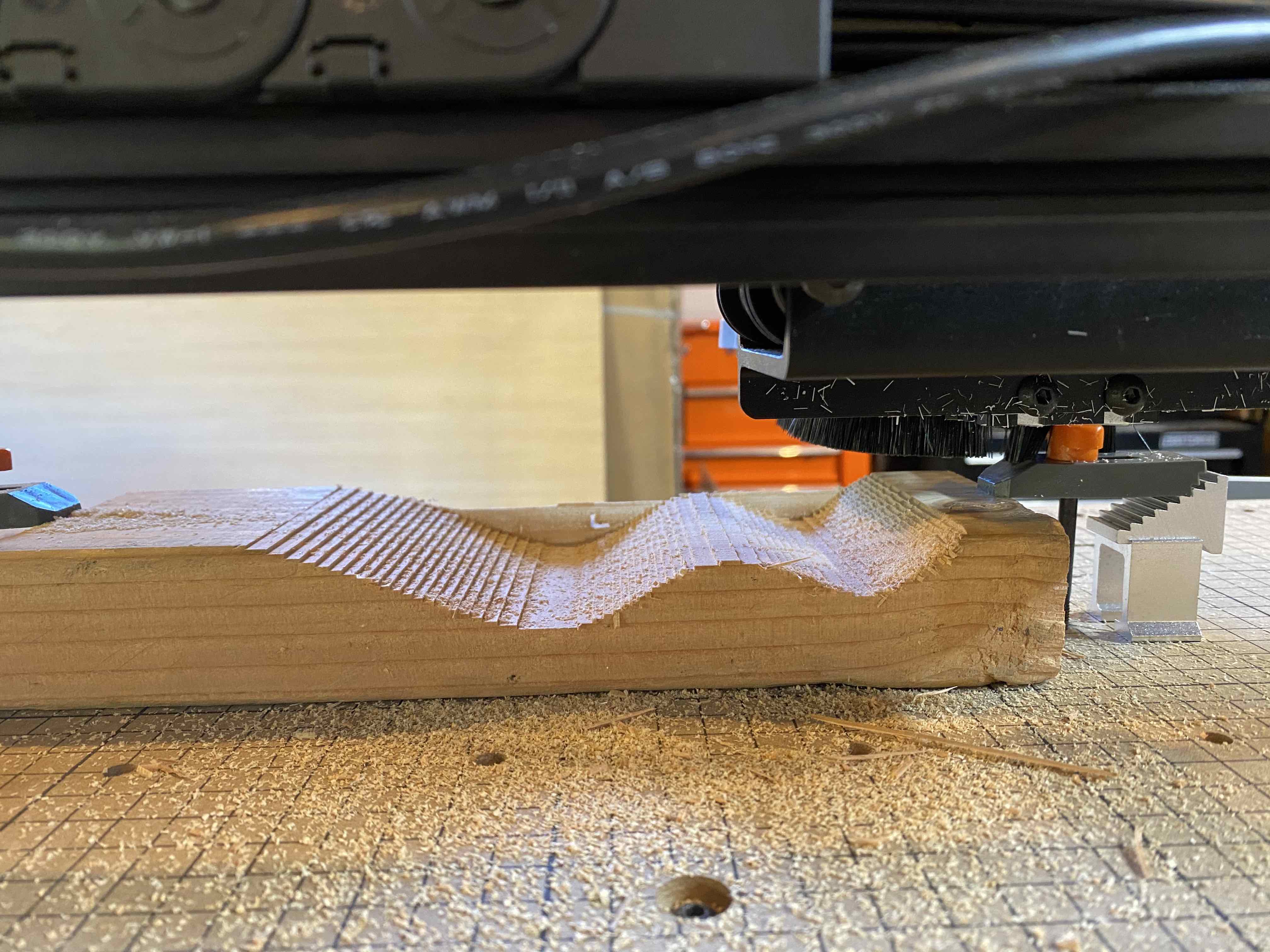

The carve
This is the workpiece after the completion of the Y-Axis clearing program
Now we began the contouring passes which were really, neat to watch. Lots of fun.
And…done.
