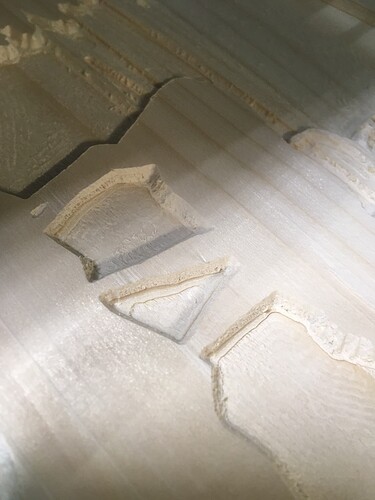

I keep getting track marks from my 1/8" downcut after the detail bit (60d) finishes. Z probe the Z axis each time. This is a pine board, testing for a bigger project on hemlock. But I can’t get clean lines. Any thoughts? Thank you!
I would check your step over (reduce it to 1/3EM size), also try up cut instead of down cut end mill.

Can you attach a photo of the marks?

I changed my step over from 40% to 30%, I’ll test it again in the morning.

Today’s the day for the real thing, I’m going to use the recommended settings from Easel. I set the step over to be 30, seems to be better on the test boards. Thanks for the feedback.
