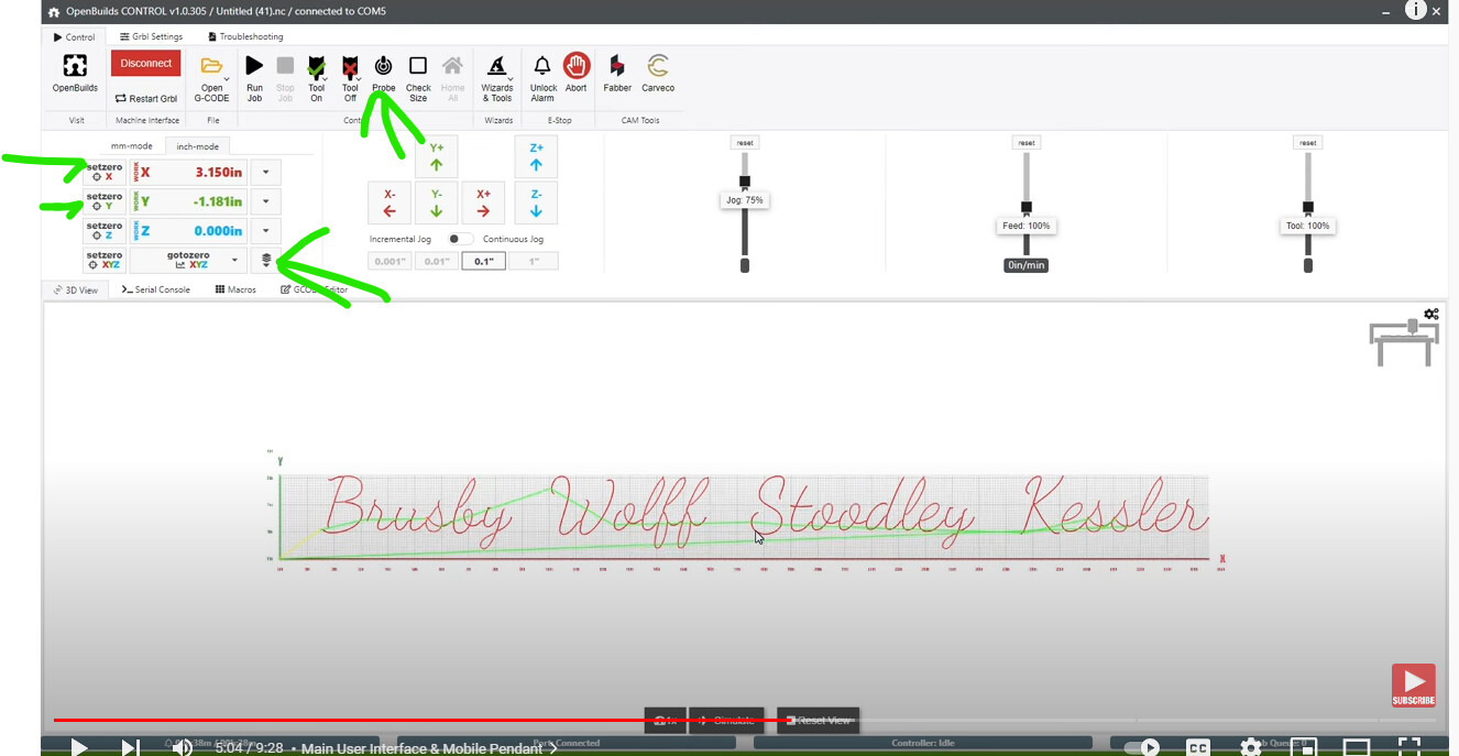

HOWEVER I encourage you to check out OpenBuilds Control. At the bottom of the Position Datum display are buttons for Saving those Jig Positions. This is referred to a G28 (jig #1) and G30 (Jig #2) and you can actually save the position as an offset from home. So after saving it (using buttons in that same area) you would going forward simply home, then click the “Go to G28” and it’ll move into the saved position, no manual jogging. Then you can set X & Y zeros. Then move it into position to Probe Z (Or paper method) and set Z zero, then run the carve. It makes the setup quicker and less manual effort to remember the offset distance since it’s saved onto a chip inside the cnc controller. which remains saved until the user over writes it by saving a new jig position over the prior one.

OpenBuilds, that’s exactly what I’m after. But I can’t get it to connect to my XCP, as I have the new firmware issue.

So switched to a windows machine, got her workin. had to set the port to 115200 in Windows Dev Manager.
