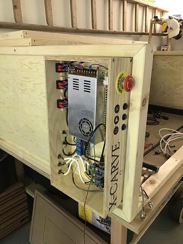

Hey i have ne machine for a while and I already finished my “box” nearly a year ago so I thought it might be time to share it.
I still have the old stock x carve which might get some upgrades in the near futur.
I added the cycle resume start and cancel buttons and an relay array to power the router and vacuum in a new controller box. I have some extension cables with aviator connectors for easy installation. I added a connector for the router to take it out of the machine and use it by hand.
I’ve a diy dustshou attaching directly under the gantry. My first metal cut was a 3D Touchplate.
To silence the machine and keep the dust to a minimum I made my box out of construction lumber and plywood plates. The inside is covered with acoustic foam. The front door unfolds to the top to get good exces to the work bed and has acrylic windows.

sweet looking setup man
but do you worry about that these wires need to be shielded? using a connection method like this is not ideal and could lead to signals getting crossed and things going a little wavy
Thanks man!
I think I haven’t had any issues regarding shielding. But I am not quite sure how such a problem would look like. My limit switches work fine and my cuts are going well, didn’t find any misaligned cuts.
I am pretty happy with my enclosure, next thing will be a new base with a box to muffle the vacuum and a dust separator right next to it.
Your foxx
MIne are hooked up the same way and have been for 2 years. No issues with crossed signals…

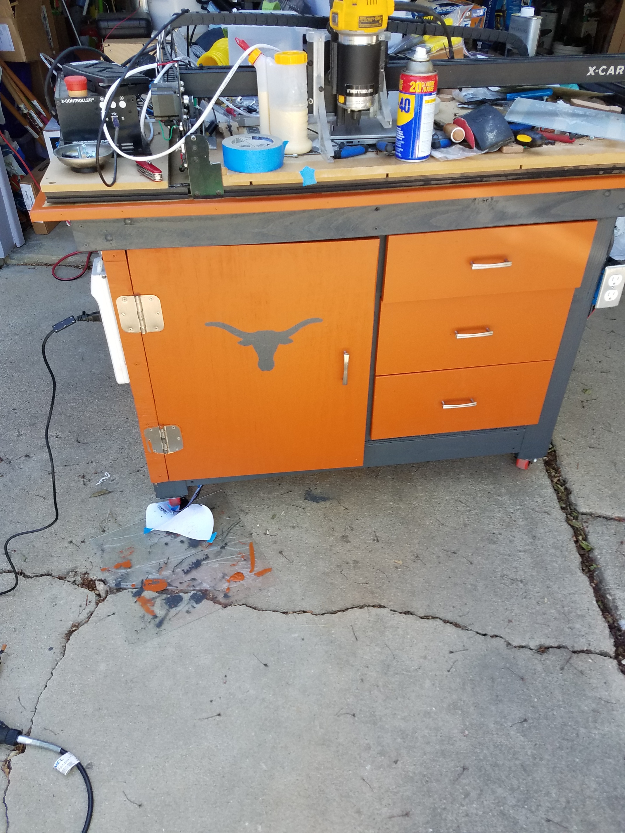

Thought I would share my cabinet for my X-Carve. I built it this past spring. Ignore the mess on top. I was organizing and cleaning. I have air and 3 outlets, also surge protector on the corners.
