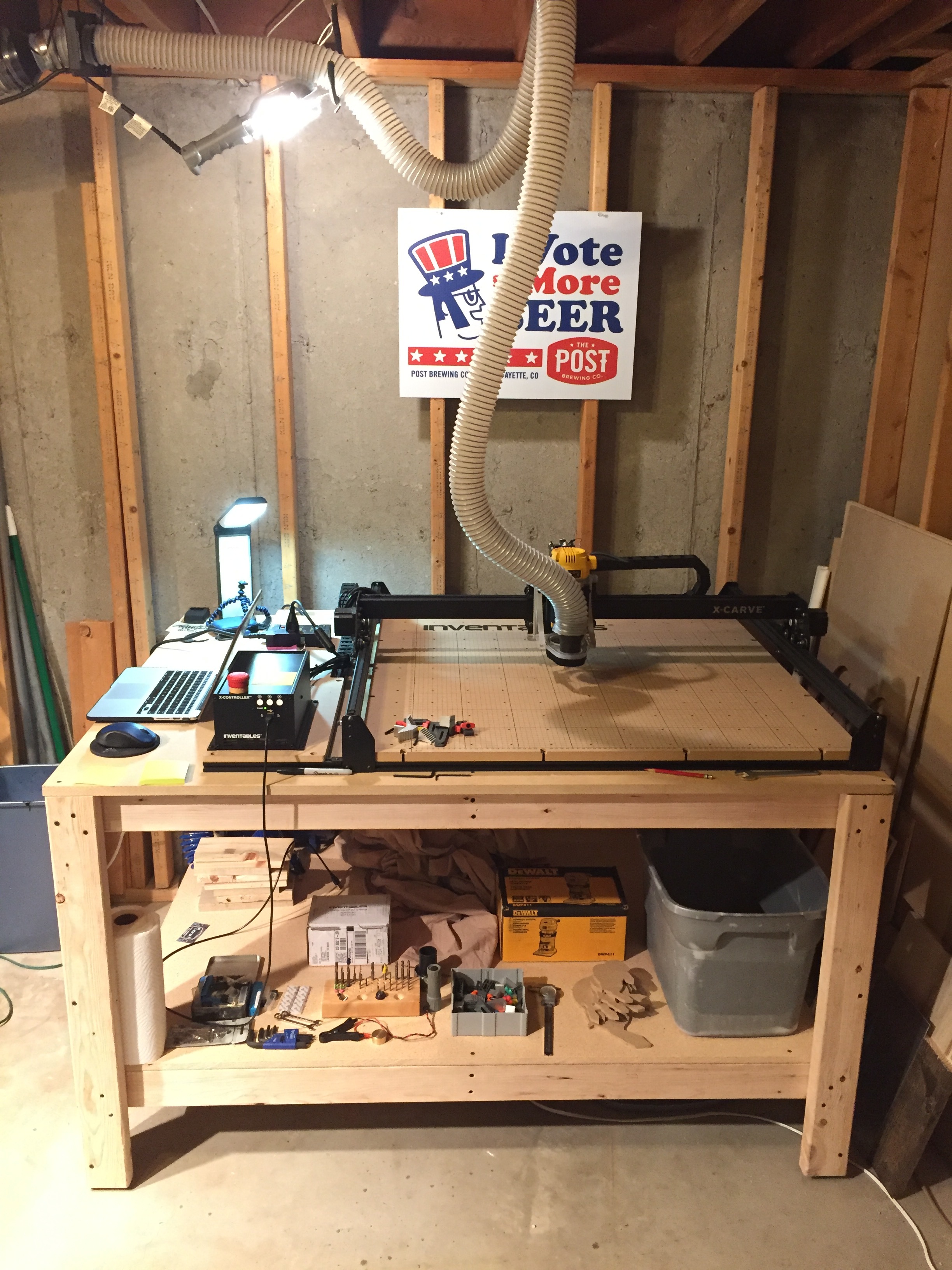

Hello everyone! My name is Joel and this is my X-Carve build ā€œshowcaseā€ now that I finally have my dust boot installed and everything aligned and trammed.
I have a small company called Clam Hammer Designs (www.clamhammer.com) making mostly custom Colorado beetle-kill flags and such and recently picked up a client that gave me the push I needed to take my business to the next level when they asked me to make some custom wood coasters and clocks engraved with their logo.
So- I ordered and built my 1000mm X-Carve and table over Christmas and wanted to wait until I got the Suckit Dust Boot installed to show everyone my setup. Alas, the Suckit arrived today and it was definitely worth the wait.
My table is built 5’ x 4’ x 36" with added adjustable feet to level it out on my uneven basement slab in my current wood shop. I have to say how impressed I am with the quality of this machine, the dust boot, and Inventables as a company.
Not to mention, the forums have been an incredible source of information and I look forward to contributing what I can as I try out some custom machining projects over the years to come. My background is in composites machining of prototype flight hardware for space exploration missions (think Orion, Juno, Osiris-REX, etc.) and it’s definitely helped me figure out this build.
My only complaint so far is the Z-axis rigidity. Using V-wheels with long bolts and that bearing that has all the tension pulling on one side (which popped my Z bearing flange out pretty quickly) seems like a bad design. I’ll be looking at linear Z-axis rails as my next upgrade and that should make this machine darn near bullet-proof! (At least in my mind :))
Even for those with zero experience in CNC machining, Inventables has done a bang-up job getting the assembly and customer support mapped out. Coupled with the vast knowledge spread throughout this forum, I am thrilled to be a new member of this great maker community!
Upgrades I still want to tackle:
  • lifted Y plates
    -stiffen up the Y-axes (ASAP)
    -install linear Z-axis
    -Blue loctite to everything w/o a nylon nut on it!

I’m getting ready to build my table and was planning on 4X6, but yours looks good on 4x5. Do you think it fits good? Do you wish you had went larger?
I originally planned on making mine 4x6’, but to save some space in the ol’ shop I cut it down to 4x5’. With the sideboard and my laptop, it’s a perfect fit for what I need. I may even get rid of the sideboard eventually to get some extra laptop/workspace, but unless you want more surface area next to your X-Carve, 4x5’ is as small as I would go.
