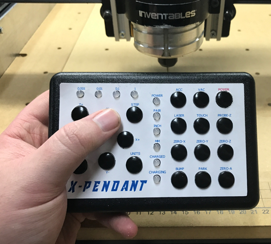

Been a while since I’ve made much progress on this with so many other projects but I finally finished the final design (for now at least). I ended up making it much smaller than the previous photos I shared. I found some improved methods with the code to cut down on the number of buttons. Unfortunately one of the chips I currently use has been out of stock for almost 4 months so I can’t make any to sell at the moment but for anyone still interested I will keep this post updated when they become available.
I used it today for the first time in its complete capacity and worked quite well. I was able to completely set up several cuts without ever touching the computer. The label layer needs a little adjustment but other than that I’m pretty happy with it.
New overall size = 6" x 4" x 1-1/8"
All the buttons on the RH side are programmable to any g-code with the exception of the POWER button. I will adjust these as I go based on what I find most useful.
Rather than “macro” vs “micro” as I did previously, the STEP button changes the step size according to the top 4 LEDs. This mimics the Easel interface.

One of the issues I was still facing was that the console is buried under a few layers of menus so after a job or at any point I wanted to start using it, I would still have to go back to the computer. Fortunately, with the Ctrl+Shift+D shortcut to open the console I learned about recently, I can now open and close the console from the pendant making it a little more “wireless”.
