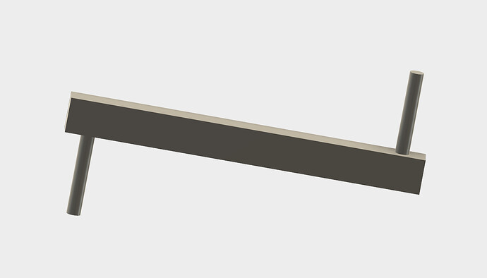

Just adding, set step over to 80% vs default 40%. Wider track provide better “data” ![]()
One can also make a tramming tool on the cheap, I took a 5" long wooden stick, drilled two 6mm holes on either side and pushed two 6mm end mills into it. One push up, the other down. The “Up-bit” go into the router and you now have a 8" span to check evenness ![]()

ok that was the best run yetpretty much not chatter ima try 40% again real quick

Note that 80% step over wasnt meant to solve chatter, just to aid with tramming your router to the waste board.
