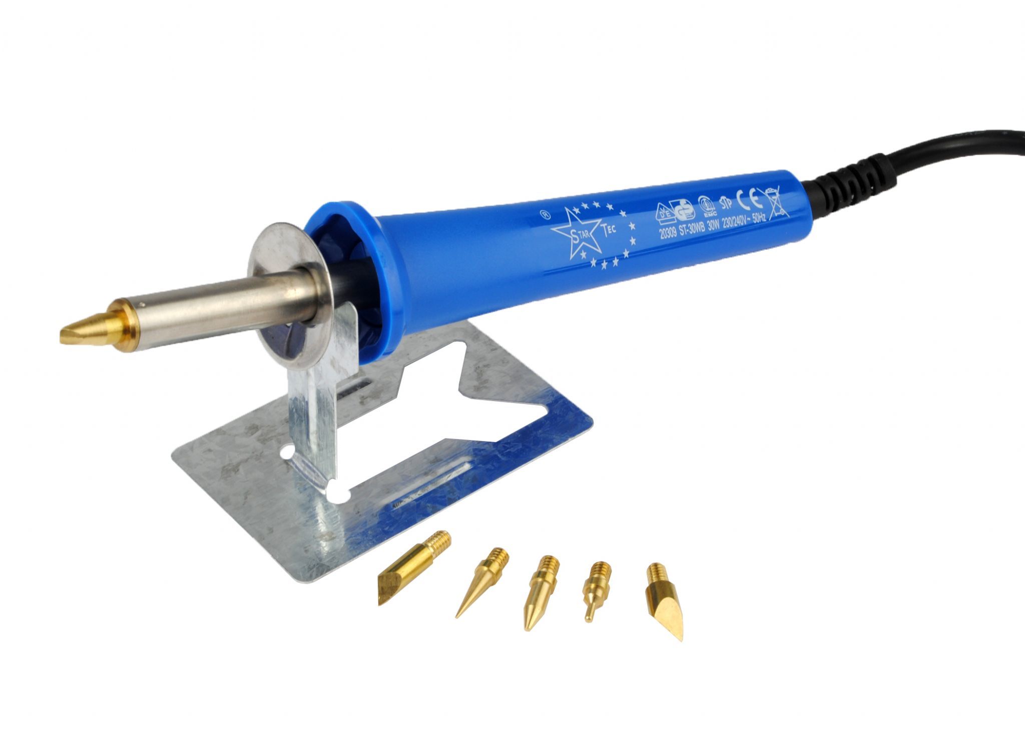

I’ve never done Woodburn img before. But random question is a Woodburn er the same thing as a soldering iron or is there something I’m missing?
They are effectively the same as the cheap soldering irons, I use mine for both soldering and woodburning. Just make sure you don’t use the soldering tip to burn unless you like the idea of solder residue on your project. :smile:
Hmm okay maybe I’ll give it a try. I got a 300$ soldering iron can set the exact temperature and warms up in seconds. Maybe I’ll buy some tips and give it a try.
There are many types and the price varies.
For the cheap ones they will do ok if your very good at the control and they are preset to one temp.
What you have to understand about the cheap versions that do not have any variable temperature control is that they will heat up to a specific temperature. You have to control your strokes based on the tip cooling as it transfers heat to the wood. There is physics math to it but I am not going to go there.
The temperature controlled ones are more expensive but offer you the ability to control the temperature. This is used for the various types of wood. Some wood requires more temp than others. For instance balsa vs redwood.
If your going to hook it up to the CNC you will need to figure out how to set the speed/feeds in order to get good results. Trial and error will be your friend. Use timed sequences and have the CNC do a straight line and see when the tip gets too cold to burn and you will know. Then you will need to set it up to work from there. Like set the feed slower if it gets too cold or faster if its getting too hot.
I am not aware of any custom G-Code to run a wood burner.
I am thinking it has to be similar to V-carve with the plunge that will ramp or start out with a light touch for a few seconds then full on for the duration of the travel. There is also thick to thin on the same line. It will require some ingenuity.
