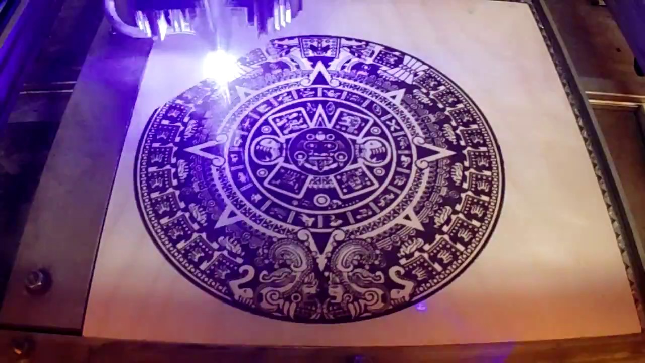

Laser engraved at 200IPM with a Feed Rate Change of 20%. 1,387,637 lines of gcode streamed with PicSender to Larry’s MultiMode grbl 1.0c.
Larry’s MultiMode grbl 1.0c will run arc and G00 commands where the J-Tech LaserMode grbl 9g will not. In our testing of both firmware versions with raster files, the feedrate execution accuracy is the same without any dwelling from the S commands.
For the last two pictures that you posted, how long did it take to burn those images to the material? I’m very interested in getting a laser set up. Thanks in advance!
I can’t remember the exact time, but it was around 1-1/2 to 2 hours. This is the Laser Diode I have.

We did a Laser engraving feedrate test with Larry’s MultiMode grbl 1.0c and here is the results.
<img src=“/uploads/inventables/original/3X/2/3/2391716116a3f201a5d5cb6ae7e2b50ea6ffb94c.jpg"width="498"height="500”>
The size is 9" X 9" and we used the Extended Edge & Skip White in PicEngrave Pro 5. The image was Dithered Black & White using the Atkinson Algorithm in the image editor & the Max PWM setting is 255 & Min 0 so the laser would just turn on/off. The step over & step ahead distance is .007" and the Feedrate was set at 200IPM, even the Extended Edge. There is 901,805 lines a gcode streamed with PicSender and the run time was 1:10:06 (4206 Sec)
The travel distance of the X&Y axis in the gcode file was reversed engineered to a DXF file and the full length is 13968.822 inches.
13968.822 inches divided by 4206 seconds = 3.321 times 60 = 199.26 IPM. The performance of Larry’s grbl & PicSender when raster Laser engraving photos is as good as it gets and the movement was very smooth.
