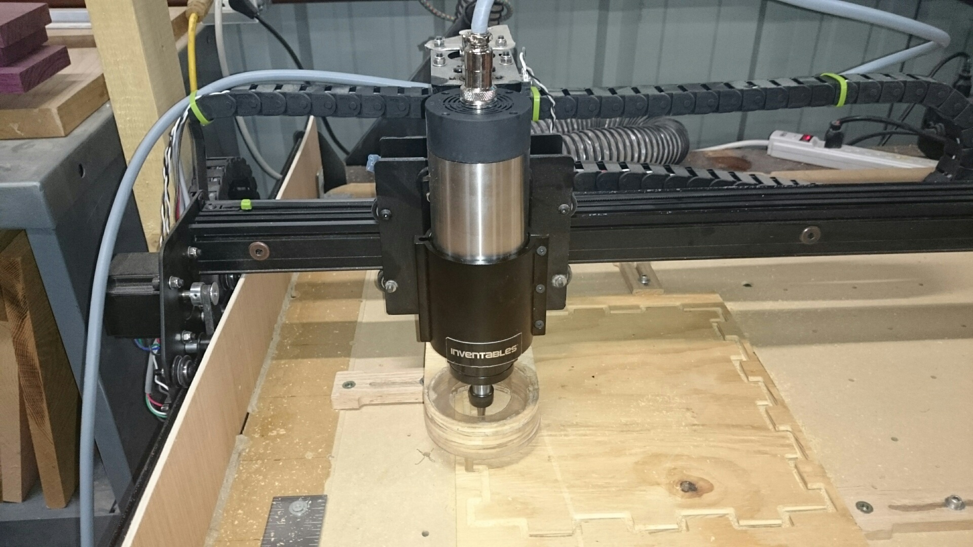

I was finally able to save up enough money for a VFD and air cooled spindle, and did some quick cuts last night. It’s a vast improvement over my craftsman router. I bought the 2.2kw VFD from www.automationtechnologiesinc.com (same price as the 1.5kw VFD), and the 0.8kw air cooled spindle I bought off Ebay for $135. I also bought the dewalt 611 mount from Inventables…and with the 65mm diameter spindle, I had to cut up 10 beer cans to make enough shim to barely fill the gap.
Definitely impressed with this upgrade, even with the minimal time I’ve been able to use it thus far.
It’s ER11, which works for me since I already have collets that match up with it.
Oh, I bought the 2.2 kw VFD from that link, but the 0.8kw spindle I bought was off of Ebay for $135.
No worries!
Only used 3 for shims ![]()
I was hoping to only have to use a couple shims, but after I surpassed 6 cans, I grew a little concerned. I measured the OD of the spindle, and it was right at 65mm. Maybe the dewalt mount I received was a little out of tolerance. Oh well, even after using 10 shims, there’s no movement from the spindle that I can see.

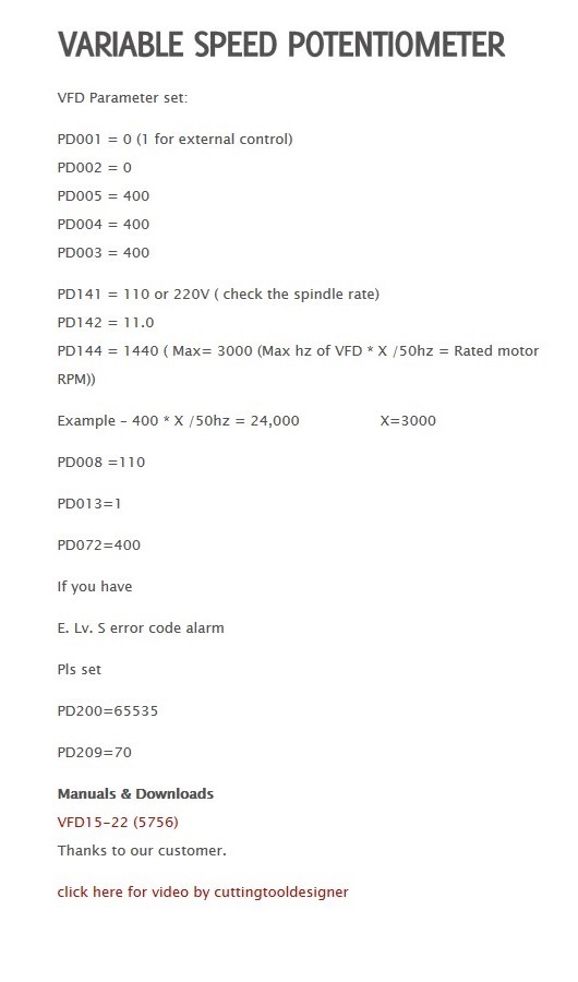

Does anyone have the VFD settings for a 110v Haunyang and a 110v 1.5kw spindle. I know most people have 220v spindle at that wattage but I have both 110v for my spindle setup and can’t get the spindle to spin. It’ll start for half a second and then the stop gets triggered
Where did you buy the VFD from? Although I have the 220VAC version, I used the settings from Automation Technologies Inc.'s website:
If you have the variable speed potentiometer on your VFD, set PD001 to 1 so that you can control the RPM’s from the knob.
I got it off ebay, there seems to be very little information about 110v 1.5kw spindles, there is a bit about 110v VFDs but spindle info is scarce. http://www.ebay.com/itm/water-cooling-1500w-80mm-er11-collet-110v-cnc-spindle-motor-matched-inverter-vfd-/181478645371?hash=item2a40f85e7b
