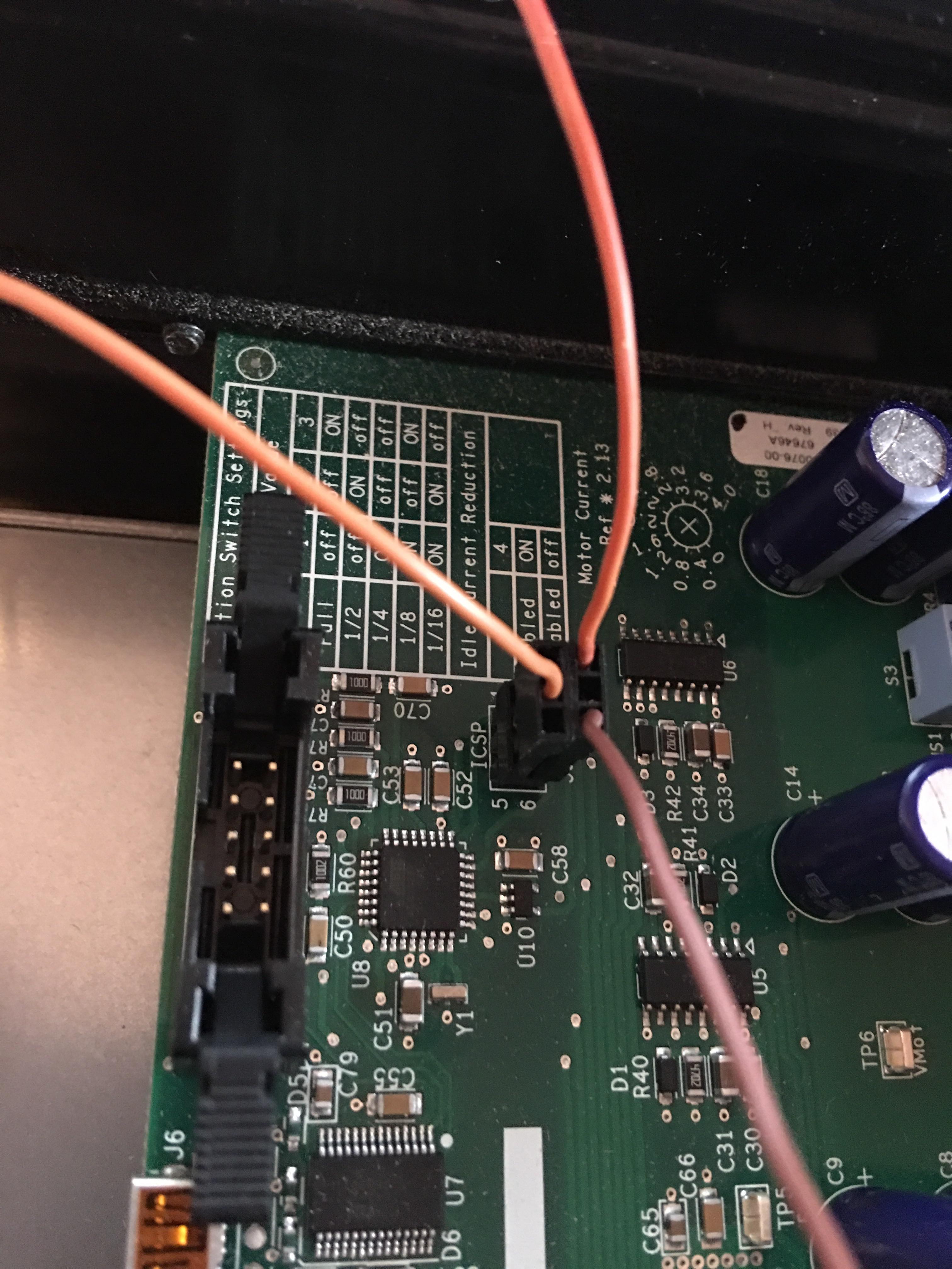

To use this setup you need to change two settings in the config.h file and recompile grbl.
define INVERT_SPINDLE_ENABLE_PIN
define USE_SPINDLE_DIR_AS_ENABLE_PIN
Warning - the bootloader will toggle the SCK pin during a firmware update operation and when power is first applied to the Arduino/X-controller. This will result in a brief spindle on condition during these two operations. Make sure that you have the spindle main power off when using either of these two operations
This is a picture of the setup:

Here is some pictures of my wiring. Please let me know if you see something wrong :stuck_out_tongue:
Can’t see what you have wired for the SuperPID, but here is what you have in the X_controller.
Cheers. Yes that’s what I done.
Nothing connected to the super-pid yet. I like to compile the xcontrolet first and then I plug it to the pid.
I just though the pictures above might be of help to someone.
