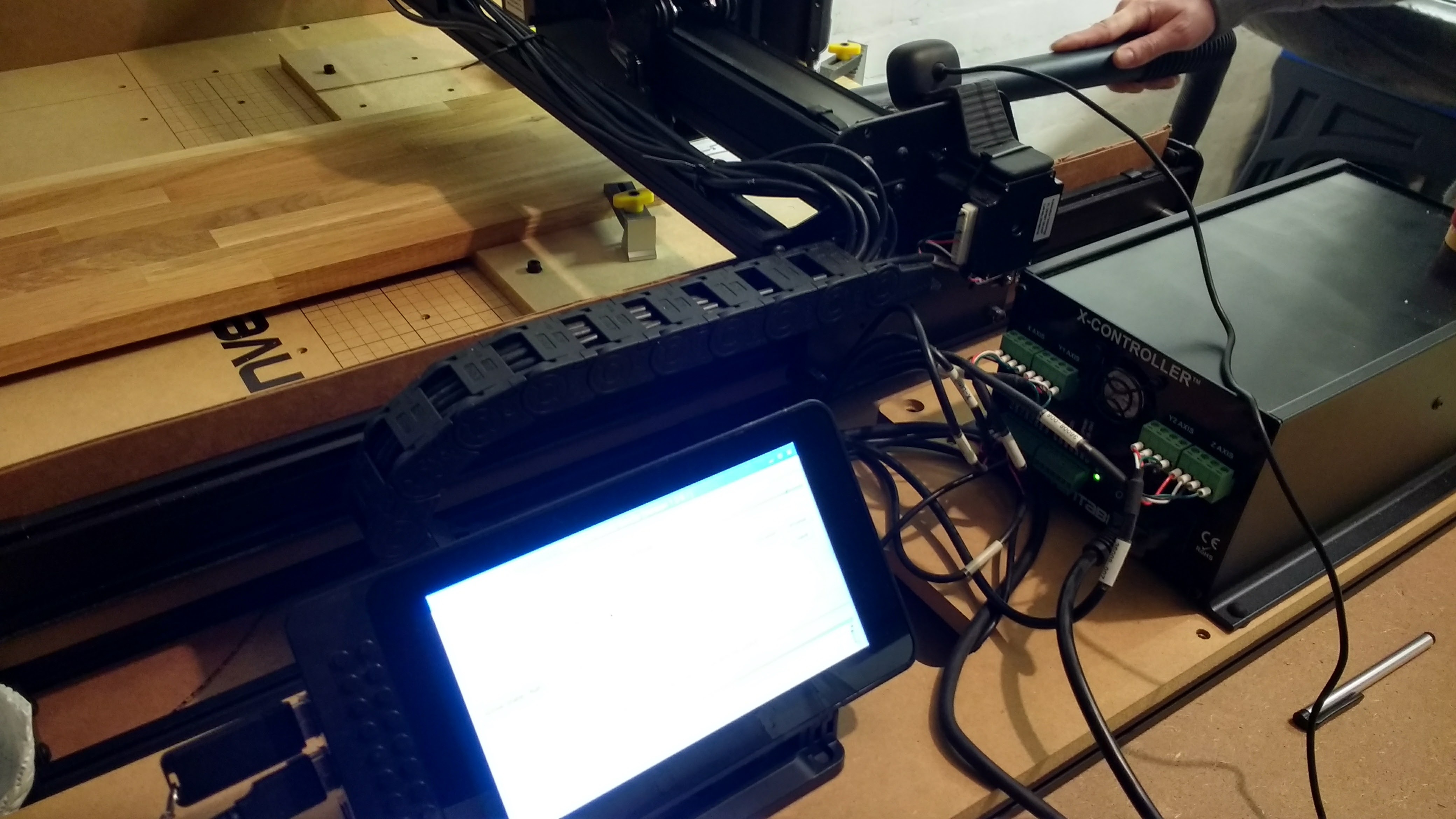

Are you having the PI run your stepper motors directly? I’ve heard about that but it isn’t what I’m doing. I have the PI connected to the older X-carve controller via usb.

I have a Raspberry Pi 3 running the UGS platform software controlling things, but also streaming a webcam attached to one of the Y-axis stepper motors. I also use VNC running on the Pi so I can keep a track of estimated finishing time, etc directly on my screen.
Works a treat so far.

Thanks! you’ve piqued my interest and I’m ordering another Pi (have one running retroPie now) to connect to the XController.
3 follow-up questions:
- Do you have a monitor connected to the PI for display of X,Y,Z etc… or do you have to use another system with a browser?
- Are you able to enter commands directly if you had a keyboard \ monitor attached to the PI?
- am I still able to use macros (like in UGS) to do the X,Y,Z touch-plate zeroing w\ the probe?
Thanks in advance!

I use my 24 inch Vizio from the camper (barely gets used anyway) and I can also control the RaspPi remotely from my main Linux system.
I also use a wireless keypad remote to input commands and jog the X-Carve this is very handy as I can stand over the material as I jog getting better control of where I am at.
Yes I use the probe function in easel as well as Charlie Zero Macro in UGCS every time I use the router (don’t need with the Laser).
I think that once you get your Rasp Pi setup you will be very happy with how well it works.
