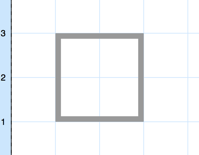

Yes everything is stock, just purchased a couple weeks ago first time I’ve been able to use it. The easel project is simply the one easel provides when it asks you to do a test carve after set up.
Test 1:
- This test piece should carve a 2x2" slot using a 1/8" bit, the left corner should be 1" up and to the right compared to the starting point. (Omit probing)
Is that what happen?
Test 2:
- Click Easel->Carve
- Under the arrow jog buttons, type 2 (as 2") and click once for X and Y direction
- Is the travel actually (or very close to) 2"?
I’m at work now, will try this when I get home in a couple hours.
TEST 1: Did not work I placed the cutter in the lower left corner, and when it started, the cutter quickly went across test piece to the right and up approx. 8" and began cutting. The box it was cutting was 6-8" in size.
TEST 2: When I changed the .1 to 2" both the X and Y axis moved 8" not 2"
Ok I was actually able to carve something, however as you can see its very large. The correct size should have been 1.5" tall, and 3" long… not 5" by 11". Also as you can see where I set my home position at, the cutter moved 8" away to the lower portion of the P and began cutting…
