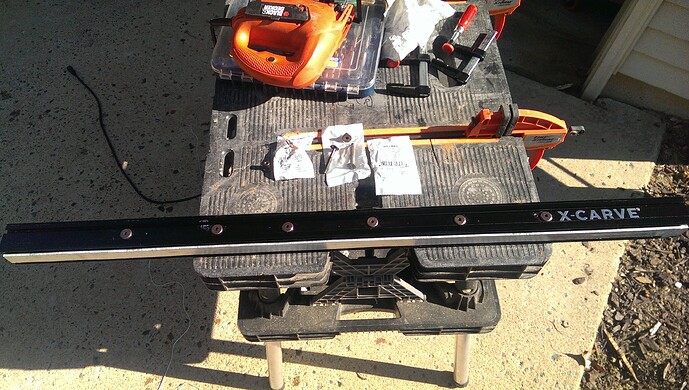

Hello there. I just wanted to make an observation about this particular part. It certainly is the right shape and thickness. However, the horizontal portion is too wide. The v-wheels cannot roll freely with this part installed. In fact, one cannot insert the carriage with the part installed. I actually tried.
At this point I have a couple of options but I think what I will end up doing is purchasing just a metal beam from Home Depot and drilling the appropriate holes. Trimming this part would be too time consuming.

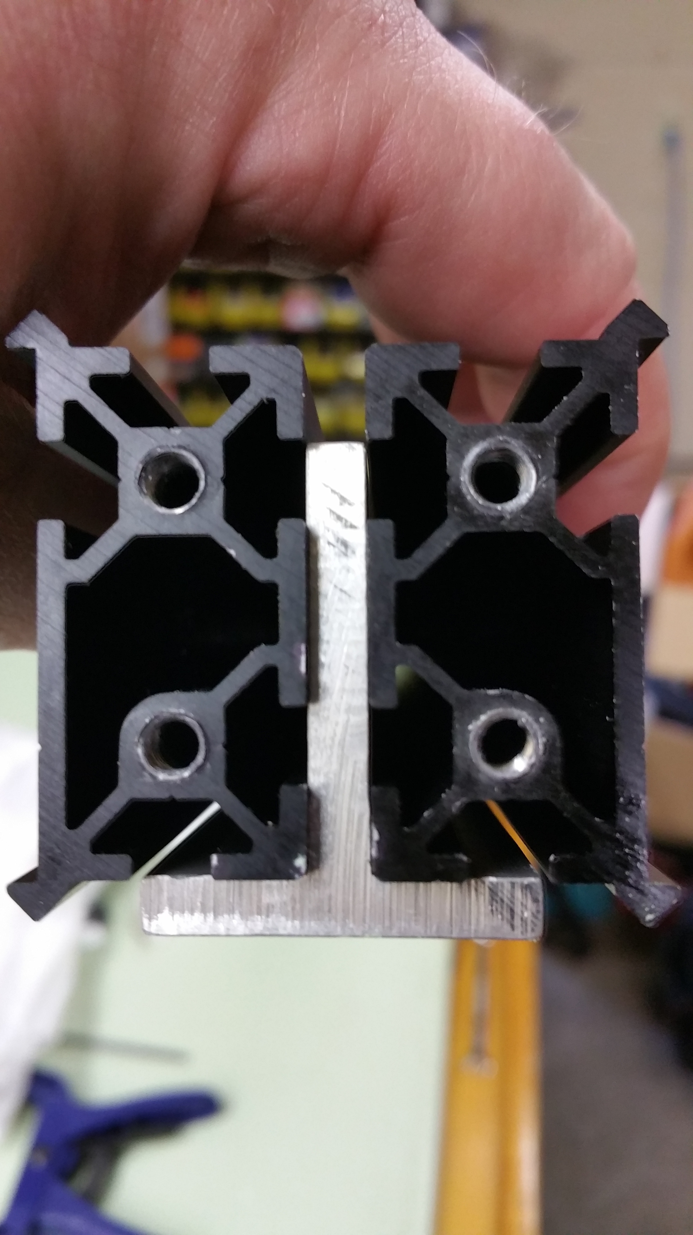

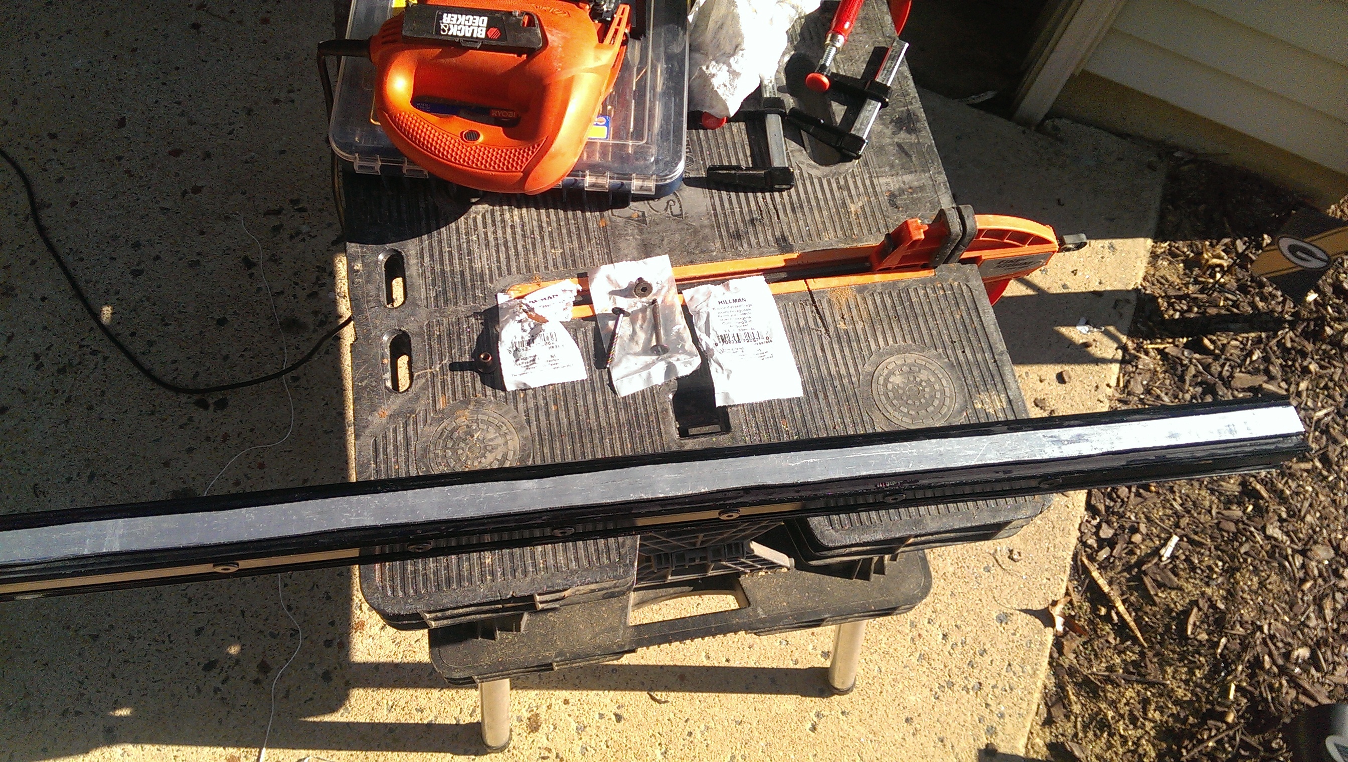

I am using an aluminum tee. It was purchased as a 1 1/2" wide and tall piece. I simply trimmed (the bottom, horizontal section) to 1 3/16" wide on my table saw with an appropriate blade and safety devices. It fits perfectly on the underside of the gantry using the same bolt-through treatment as the flat bar. I will post some pics when I get a chance. I believe the aluminum tee is more rigid (and lighter) than a flat bar. The bottom of the tee cradles the makerslide and makes it virtually impossible to sag–it holds itself up.
If you are uncomfortable cutting aluminum, or are not equipped to do so, a local machine shop could do this for you for an affordable price.
I had a steel flat bar in place but decided to try the tee due to the observation I had of the gantry “bouncing” a bit during fast direction changes. There was no longer any noticeable flex, but rather a certain inertia present when the Y axis changed direction. Fastening the whole frame to the table may have eliminated this, but my thinking was that over time the extra weight of the steel may wear on the motors and belts. The aluminum tee is half the weight and is, in my opinion, a better solution. Sag, bow, and twist are gone from the gantry–as well as the inertia bounce. I’m not an expert on the physics by any means, but my eyeballs and test cuts tell me the solution I have implemented works the best for my situation.

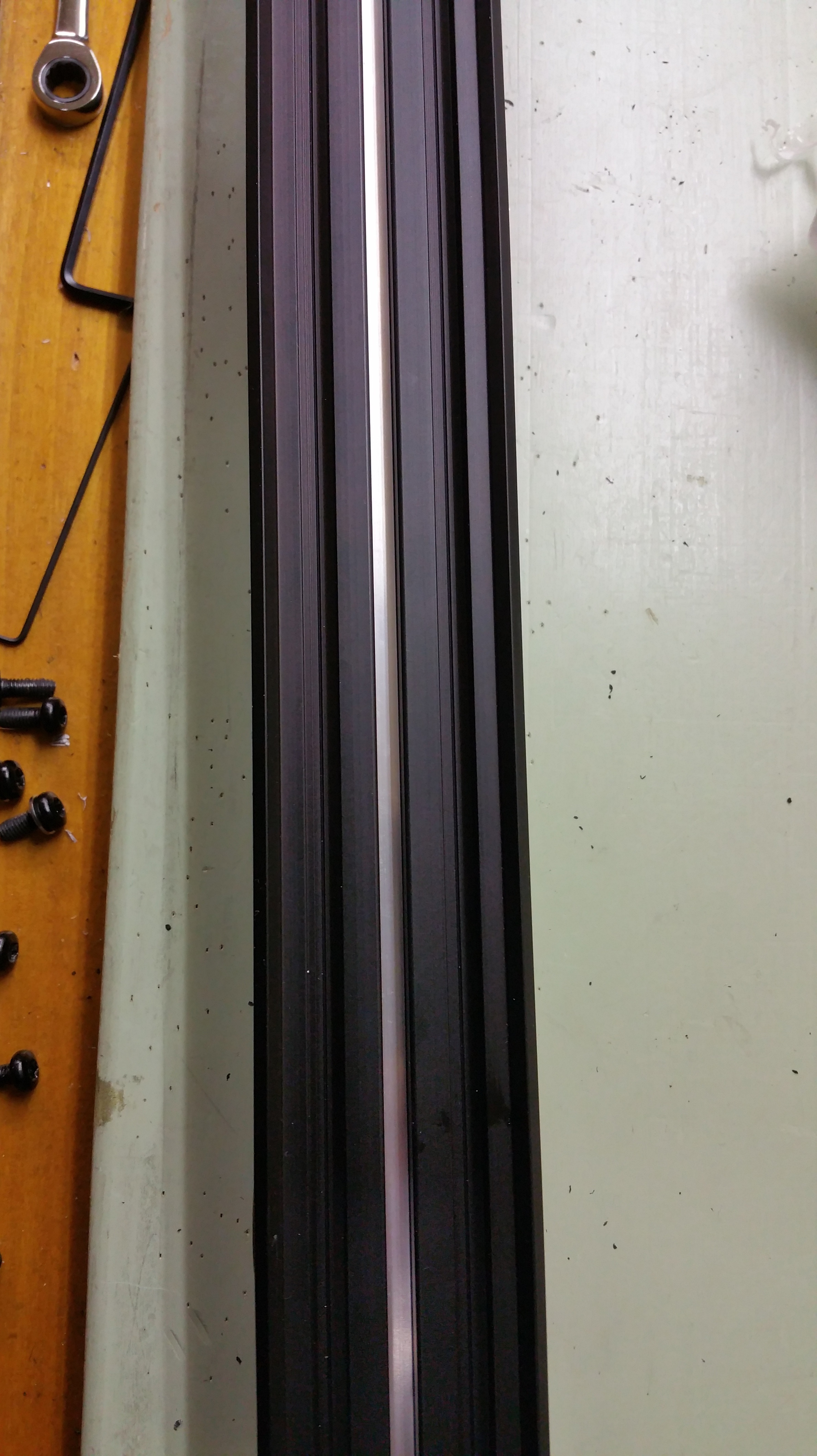

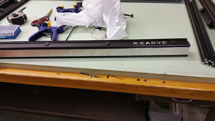

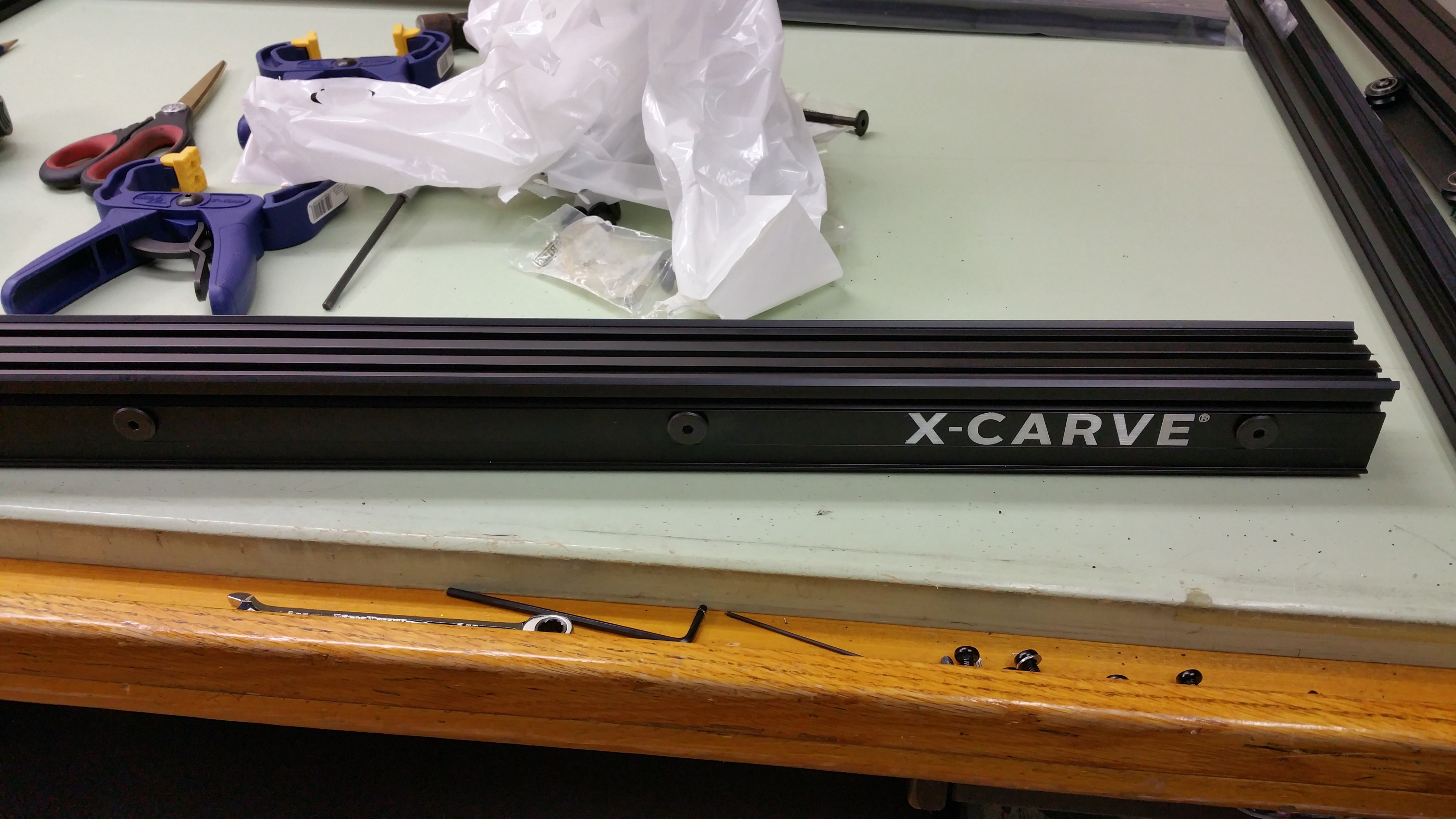

Here are some pics of the mod using 1 1/2" aluminum tee, milled down to 1 3/16" width. It ends up exactly even with the edge of the T-slots on the bottom of the makerslide and the top edge of the side T-slots.
This has proven to be more rigid than the flat steel sandwich for me, and the total weight of the assembly comes in at at just under 5 lbs. without the cradle. The steel mod weighed in at almost 6.5 lbs. without the cradle. It feels more solid than the steel as well. Almost like one solid piece; I can’t flex or twist it in any direction by hand with all the force I can give. The steel bar had a hint of flex on the flat side (bowing) but nothing top to bottom (sagging). That may be why I saw a spring or bouncing (kind of like a whipping backlash) action with fast direction changes on the Y axis. I am getting none of that with the aluminum tee.
The aluminum tee cost me $27 for an 8-foot section. I have enough left over for another 1000mm or two (almost three) 500mm X-Carve upgrades. Highly recommended if you want maximum rigidity using the stock makerslides. If someone really wanted to, there is enough room to add t-nuts and recessed machine screws to the bottom of the assembly. For me, the furniture bolts seemed more than adequate.
As a side note… there was an issue with an uneven spot on the “V” edge of the makerslide with the “X-CARVE” decal and it had to be replaced so the V wheels would roll smoothly. The pic without the decal is the final assembly with the new makerslide.

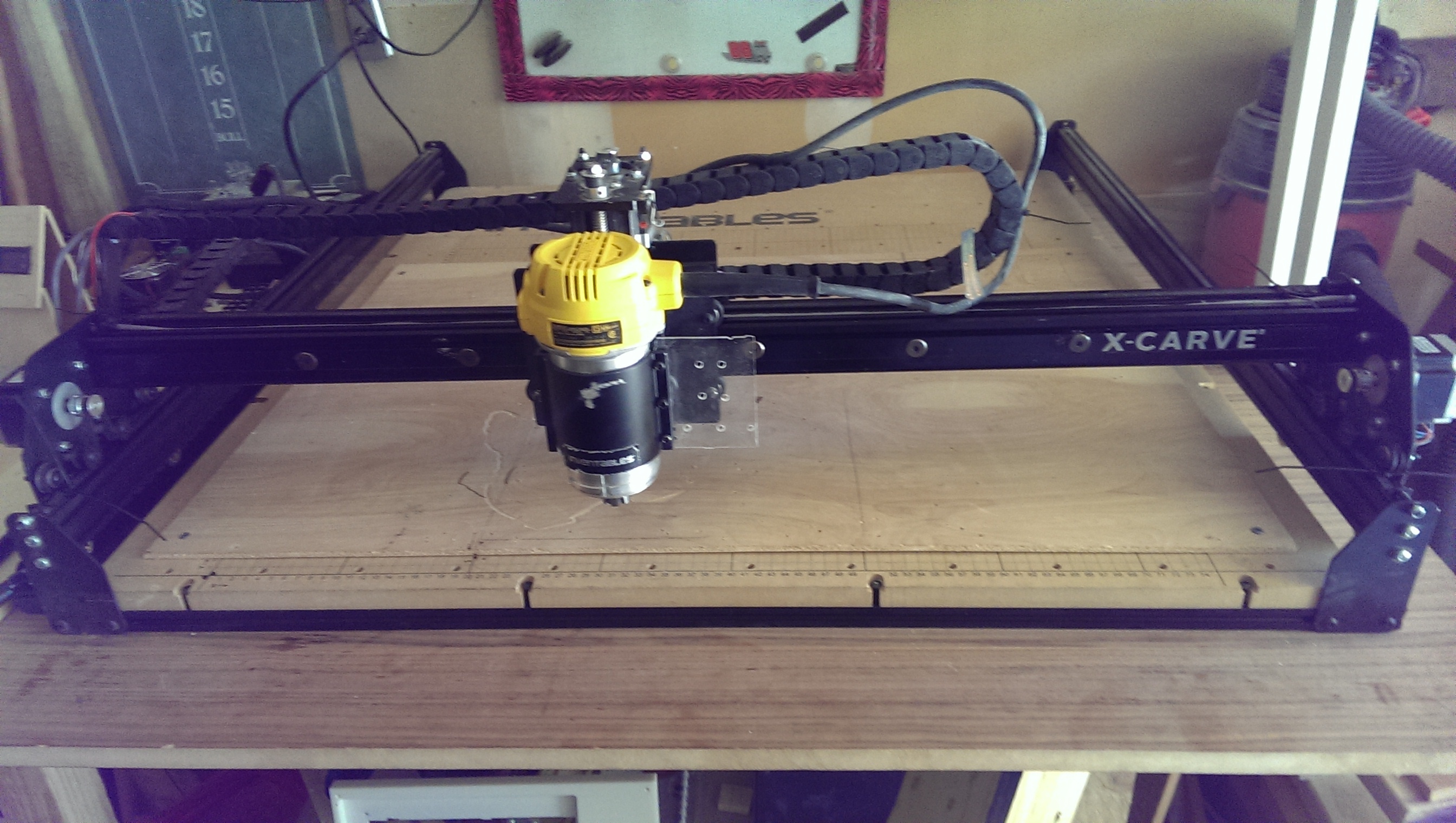

3Ryan, my two cents worth. If you are running the 300W spindle there is no need for this mod imo, but if you are going to a heavier router (DeWalt611 or other) and you are going to hang a dust shoe from the router, then you will need to stiffen the X gantry. I am speaking from personal experience here. By adding the 3/16" X 2" steel bar it resolved all of my carving problems.
I should edit: problems caused by the heavier router and weight of the addition of dust shoe.

i did the same thing with the tee-bar and it looks like you did the same thing i did with the groove up on one side and down on the other.
not how i had planned but how it came out.

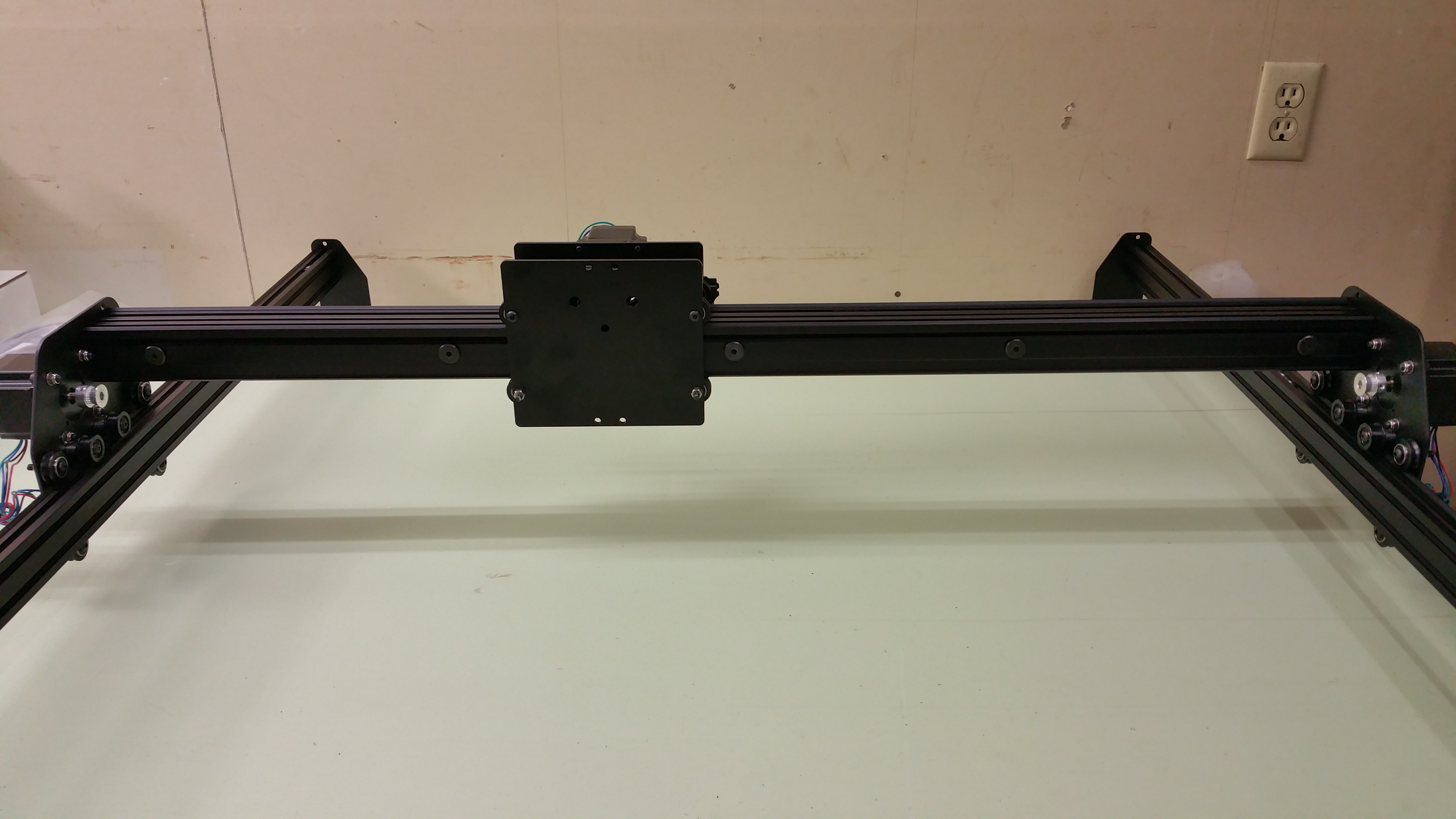

the instructions say the groove must be up on the back piece for the limit switch to function properly. will turning this around so the x-carve label is in back affect anything and does the groove need to be at the top in the front for any reason. i’m doing the mod as i build so these are things i would probably already know had i put it together.
I reversed the makeslide the other evening because mine were upside down as far as the home switch actuator was concerned. It turns out that the micro-switches I have don’t contact the home switch actuator no matter which way the makerslide is oriented! I fixed this by bolting a small piece of aluminium angle in place of the switch actuator and this gives a much bigger surface for the micro switch to hit against.
U can’t have aluminum tee on top because of belts and idlers
