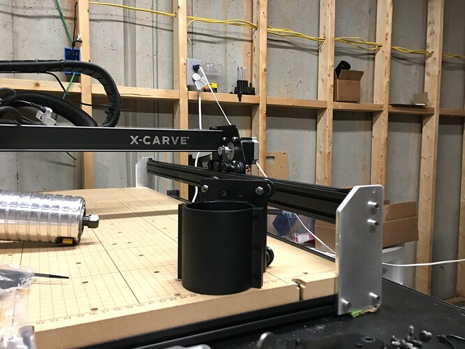

My plates arrived yesterday. Plan is to put them on tomorrow. I’ll provide the info I told you about once I get them installed.
Just ordered a set for my 750
My plates arrived this past Saturday, two days early!. They look great. Thanks again to Charley for a great product and outstanding customer service.
Ok here’s what I found.
- the stock 8 mm screw has no thread engagement of the tee nut.
- a 10 mm screw will work but its bottoming out with maybe 1 or 2 turns, I opted to pass.
- a 12 mm screw works great for the tee nut.
- if your belt clip screw is just barely through the stock end plate, it won’t go through the new one. You have to either let more belt out or get a longer screw. One of mine needed some slack let out (which was easy with the new belt clips).
I ended up using 12 mm for the tee nuts (4 mm longer than the stock) and 16 mm for the maker slide. I also cheated and used a scissor jack to support my X axis and took both plates off and then raised the entire side. Worked like a charm and I checked level afterwards and it was within 0.05 degrees which is probably where it was before.
Overall, another fine product by Charley.

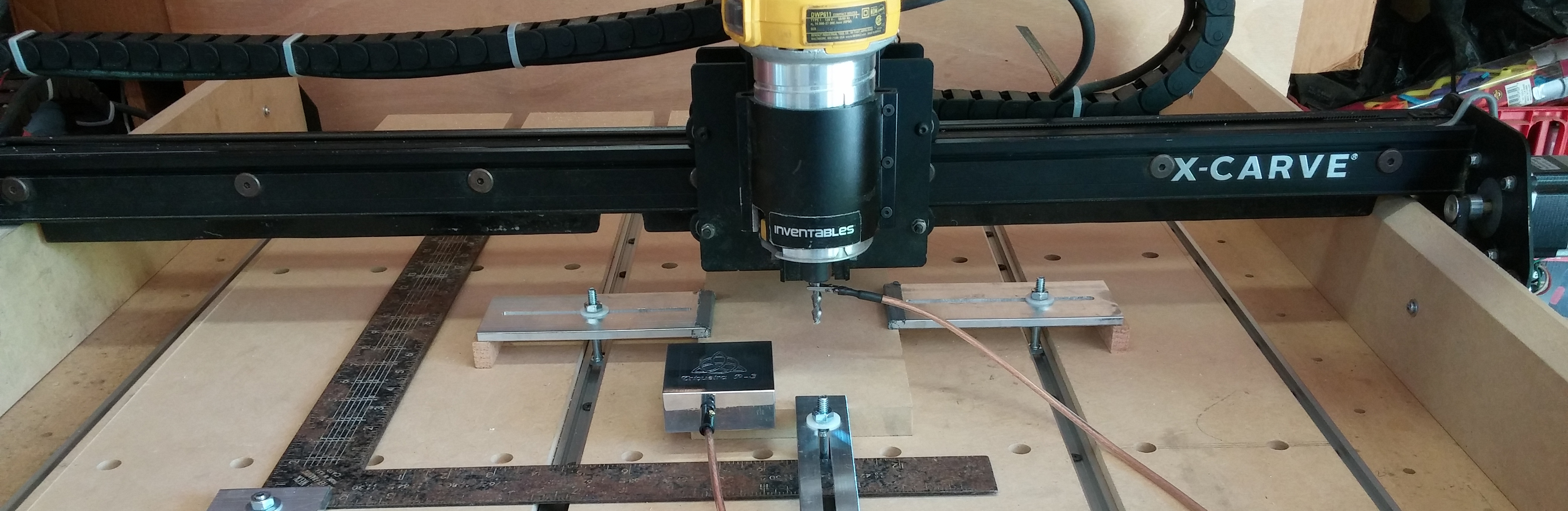

I’m game but I’m not sure what you need to stiffen your Y axis. On my machine I cut some 3/4 inch MDF that simply screws to the inside of my Y axis rails. I made them as tall as possible without interfering with the gantry moving forward and backward. I used insertion nuts on the Y axis rails to screw it them on. This stiffed the rails very well plus acts as a shield to keep debris away from my Y axis drive belts and wheels. This is particularly important to me since 90% of the work I do is milling aluminum. Although it doesn’t keep 100% of it out, the use of a dust shoe and the MDF stiffening/dust shield does a very good job of keeping the belts/rollers clean and the Y axis stiff. 99% of the debris that escapes the dust shoe remains on the table and not in the Y axis track so I can live with that.
Because the MDF extends all the way down to the waste board it also prevents any sagging of the Y axis rails. This picture show my setup. You could use some “L” brackets to screw to the MDF and waste board to stiffen it even more but I didn’t find it necessary. The X-Carve doesn’t do well with deep depth of cuts primarily due to the lack of rigidity in the Z axis so keeping it within it’s capability never really presents the need for much stiffening of the Y axis. This was an inexpensive and easy mod to apply and has worked very well for me.
