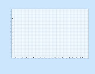

Does anyone have the exact spacing for the x and y axis? I know that they are different spacing. I am trying to make a fence to square up project on the table. Thanks.
Or if someone already has the plans that would be great too.

those are spaced at 75mm that’s the standard X-Carve I believe
there’s a template here that appears to be laid out for the XCP but it’s setup for a laser cutter These holes are spaced at 72.5mm centerline spacing:
> [@Bump Stop/Corner Bracket Template](https://community.inventables.com/t/bump-stop-corner-bracket-template/119944/3):
> @TimothyWood1 Those are measured on center.

Here’s the 72.5mm spaced one setup in Easel. The first file is the lines and numbers if you want to carve that.
I don’t have the XCP, but can you confirm that this works If you do use it? Thanks!

This one worked.
