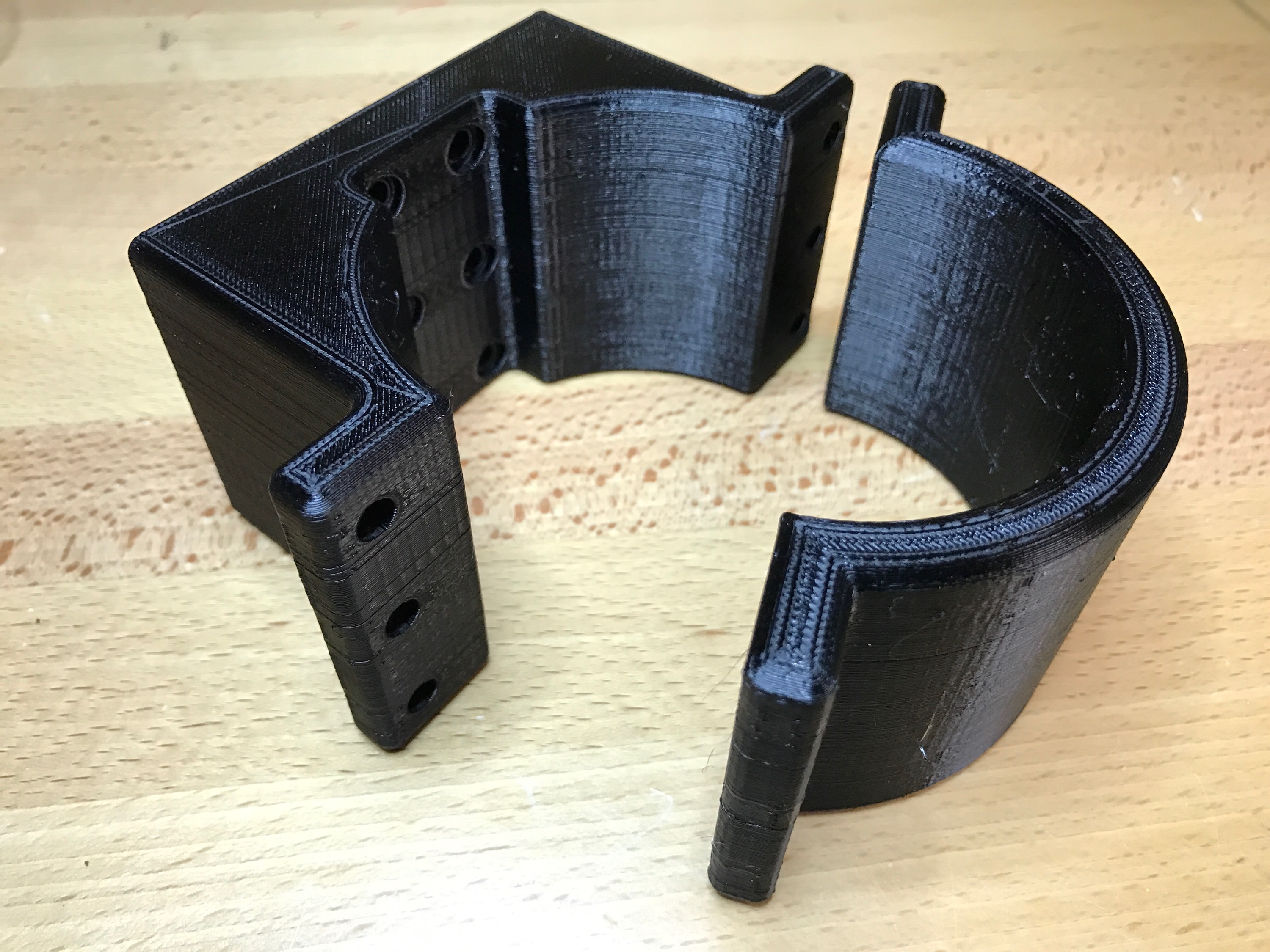

Thanks for everything you have shared here, Chris. I am about to place an order for my VFD in the coming hours and I am already most of the way through printing your 80mm mounting bracket. The universal spindle plate from Inventables has been ordered as of last night to mate with it. This will be replacing my more standard Dewalt setup.
Couple of questions, if you don’t mind:
  • Your 3D printed mount: has it proven to be solid for you? No flex or other instability issues under the stress of use in this manner? I’m printing mine right now with 40% infill, but opted to use PETG rather than PLA for its durability and tendency to be less brittle. Halfway through I’m now wondering if that is a mistake on my part that might introduce even a slight bit of elasticity/flex that PLA wouldn’t. On the other hand, perhaps that is better than PLA which could maybe stress fracture rather than give? Any thoughts from experience thus far?

14.5 hrs later, I have my 40% infill, PETG spindle holder ready to roll. Lightweight but strong.

As far as the mount, I have not had any issues that I have noticed from flex; however, I have developed a small stress crack in the front piece. I does not appear to have caused any issued and I have made a few cuts with it in that condition without issues. so far I am chalking the crack up to over tightening. I am going to print a new copy on my Form 2 in the super uber resin soon.

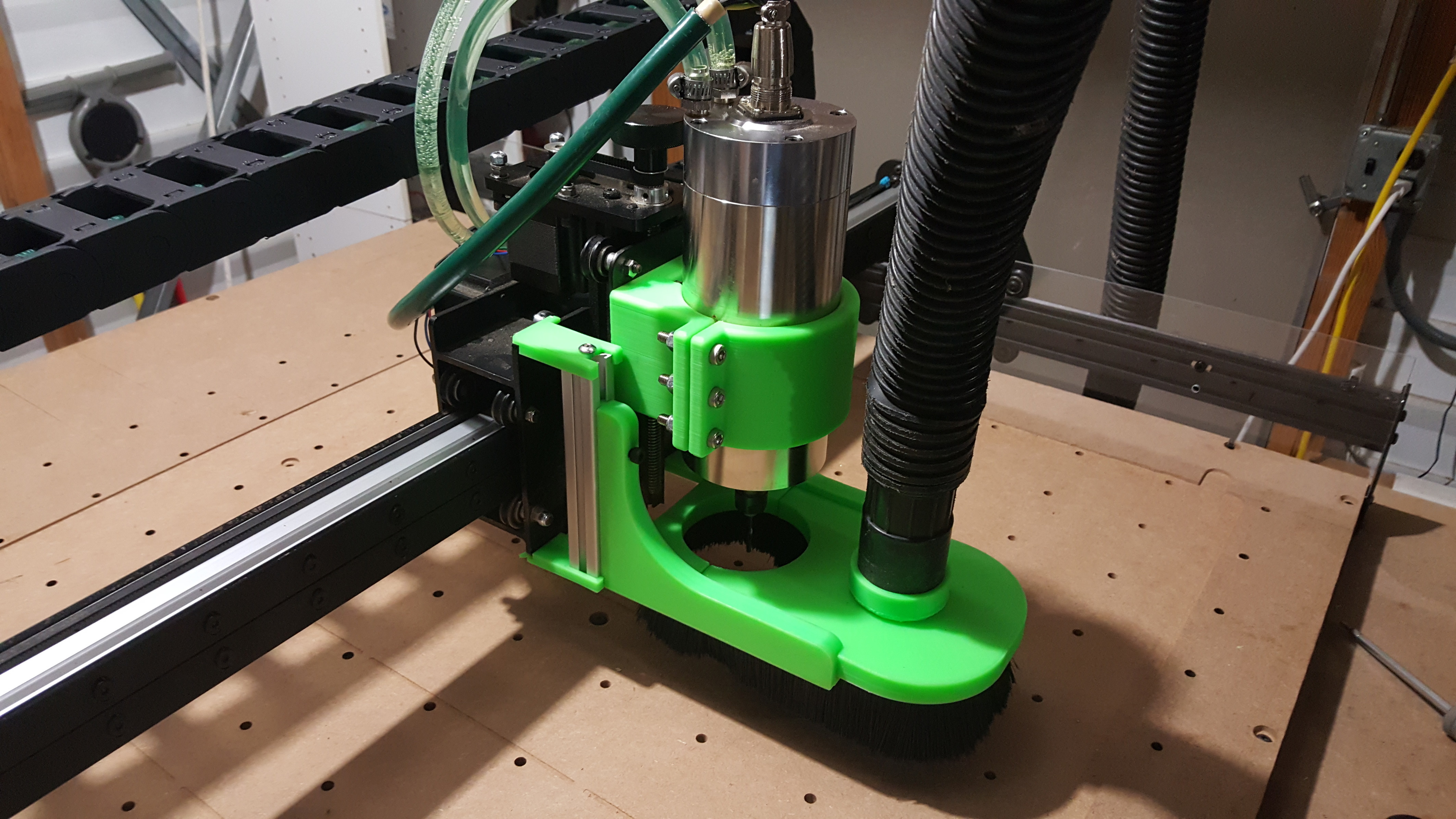

You will probably find the Suckit Distboot gets in the way of the spindle going all the way down. The design I have was from another forum member, and the hole is not large enough nor outset enough for the motor to go down without pushing it around. I need to make some design changes and print a new one. I would be happy to share that stl if you feel you need it, just let me know.

I had ended up with a 110v VFD with built in step-up to 220v. The spindle is the 1.5kW air cooled design. I might change some of this in time. I’m running new power out to the workshop probably this week that would open the door to 220v, but so far my preliminary and minimal testing seems solid.
If the RPM info on the VFD is to be believed, I’m getting what seems to be the proper range of speeds. I’m using 7200 as my minimum since I gather I shouldn’t run air cooled below about that range for cooling purposes. Currently this minimum is me being careful since the various mechanisms (VFD or GRLB) for declaring minimum speed seem to screw with the on/off and proper ranging across 0-10v if I have anything but zero as my min. I might have to revisit this in case I’m approaching it wrong.
This afternoon, I got the VFD attached to my X-Controller and am successfully turning it on and off and setting my spindle speeds via gcode. Initially I was simply getting full on or full off with M3 no matter what and I started adjusting the firmware defaults (I’ve done a lot of Arduino work over the years, so am comfy there) to declare my RPM min/max so the 0-10v would scale properly. Nothing I did was making a difference until I realized I simply needed to adjust $30 & $31 in the GRBL EEPROM-stored settings. Voila. S8000 followed by M3 and I’m at 8000 RPM. M5 and I’m off.
I did noticed the RPMs were off by maybe 100-150 at any declared speed. I tweaked the behavior by diddling with the $30 RPM max so the scale relative to the 0-10v from the X-Controller mapped more closely. Now I get about 7220 for S7200 and am figuring that’s probably sufficient.
I’ve only been doing air cuts so far - partly to be cautious and observe each step of the upgrade, but also because I misread the collet info and wrongly assumed my Dewalt stuff was E11. Turns out the nut threads on fine, but my current collet springs don’t fit into the spindle. So I’m limited to the E11 w/1.4" spring that came on the spindle (which amounts to only a few end mills in my kit for the moment) while I await a new set of collet nuts and springs to arrive that are truly E11. Then I can use my 1/8" end mills again. Should arrive Wednesday.

  • Chris - your mount seems to work great! It’s holding super snug using the PETG 3D printed version I pictured in my last post. I’ve not looked closely yet to check square on everything and I’d have to ponder how to even tweak that if it’s an issue. Any concerns there?

Quick update to my own post above: I solved my spindle startup time issues. I found where I could reduce the spinup time in the VFD. I knocked it back to about four seconds (from a default of 20) and also added a G4 P4 to my pre-processor so add a little delay for coverage on job start and tool changes. Seems a good balance.
While doing some testing tonight, I also touched the unit at one point and felt a minor shock. I tested it and found between 35v and 130v (not sure on the amperage, so might not be quite as bad as it sounds) between the metal housing of the spindle and ground in the VFD. This led to some discoveries regarding ground on the circuit powering the VFD (now resolved), but it also got me digging a bit deeper about the spindle.
Some research online revealed a lot of people finding that pin #4 on the spindle (ground) isn’t connected. I opened mine and, sure enough, pin four (which I had dutifully wired back to the VFD ground in my shielded cable from the outset) had no wire on it internally.
I drilled a small hole in the plastic housing where the wire bundle attaches to the spindle, soldered a wire to pin #4 and attached it under one of the screws in the housing. I now have continuity between the spindle housing (right down to the end mill itself) and the ground back at the VFD (screw terminal E). After doing this, I no longer get more than, say, a volt (if that) off the housing when measuring like before and not so much as a tingle when touching it.
Perhaps on other systems a metal mount might have led to ground, but between my 3D printed mount insulating the spindle and the plastic v-wheels and delrin nut sitting between the spindle and the X-Carve frame (which I doubt is grounded anyway), it seems all the more critical to make sure that pin #4 grounds the housing.
