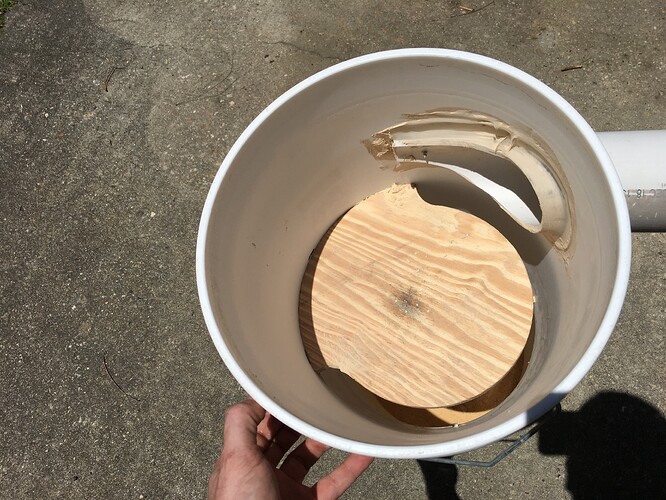

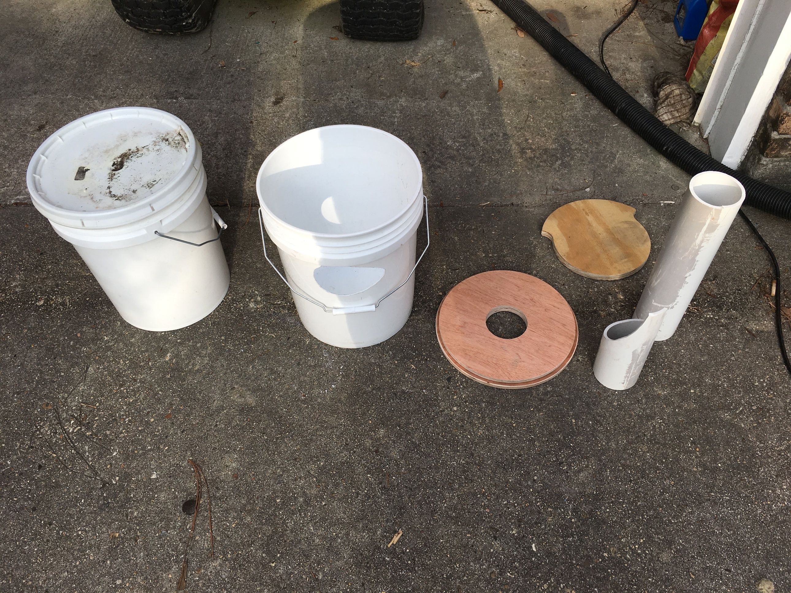

I made a ‘Thein Baffle’ style separator modeled after Mathias’s design Building the two-bucket cyclone It utilizes two 5 gal buckets and almost no dust gets to the shop vac.
No more cleaning filters!
I’ve done the same thing and can fill up the bottom bucket and only have a couple of tablespoons of dust in the shop vac. I did upgrade my shop vac. I switched to the harbor freight dust collector blower. I don’ t even need to run it with a filter bag. That is how good this design works.
