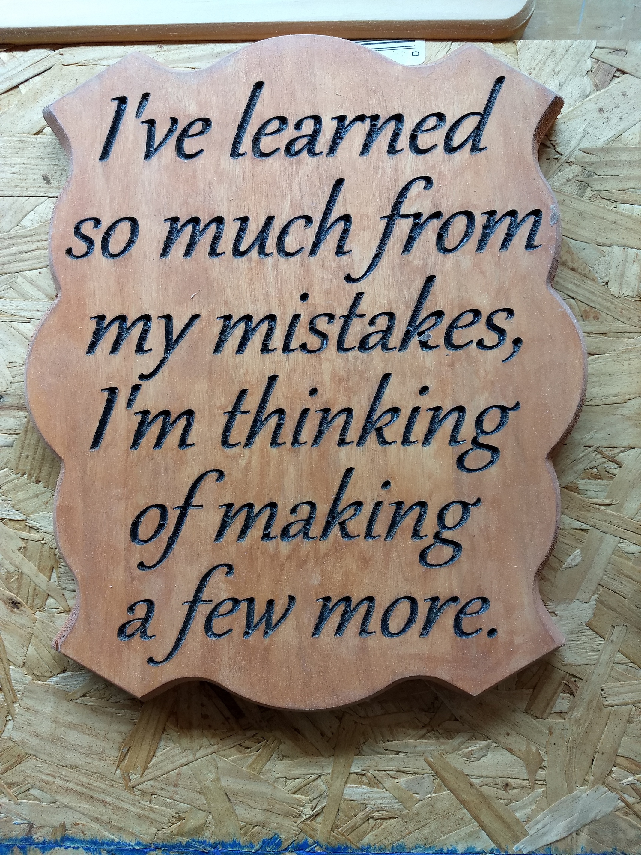

There’s a reason I have this sign hanging in my shop.
So today I’ve been happily carving away and finally got this plaque made for my granddaughter.
A little sanding to get rid of the cutter marks a couple coats of polyurethane and it will be good to go.
I hope she likes it.
