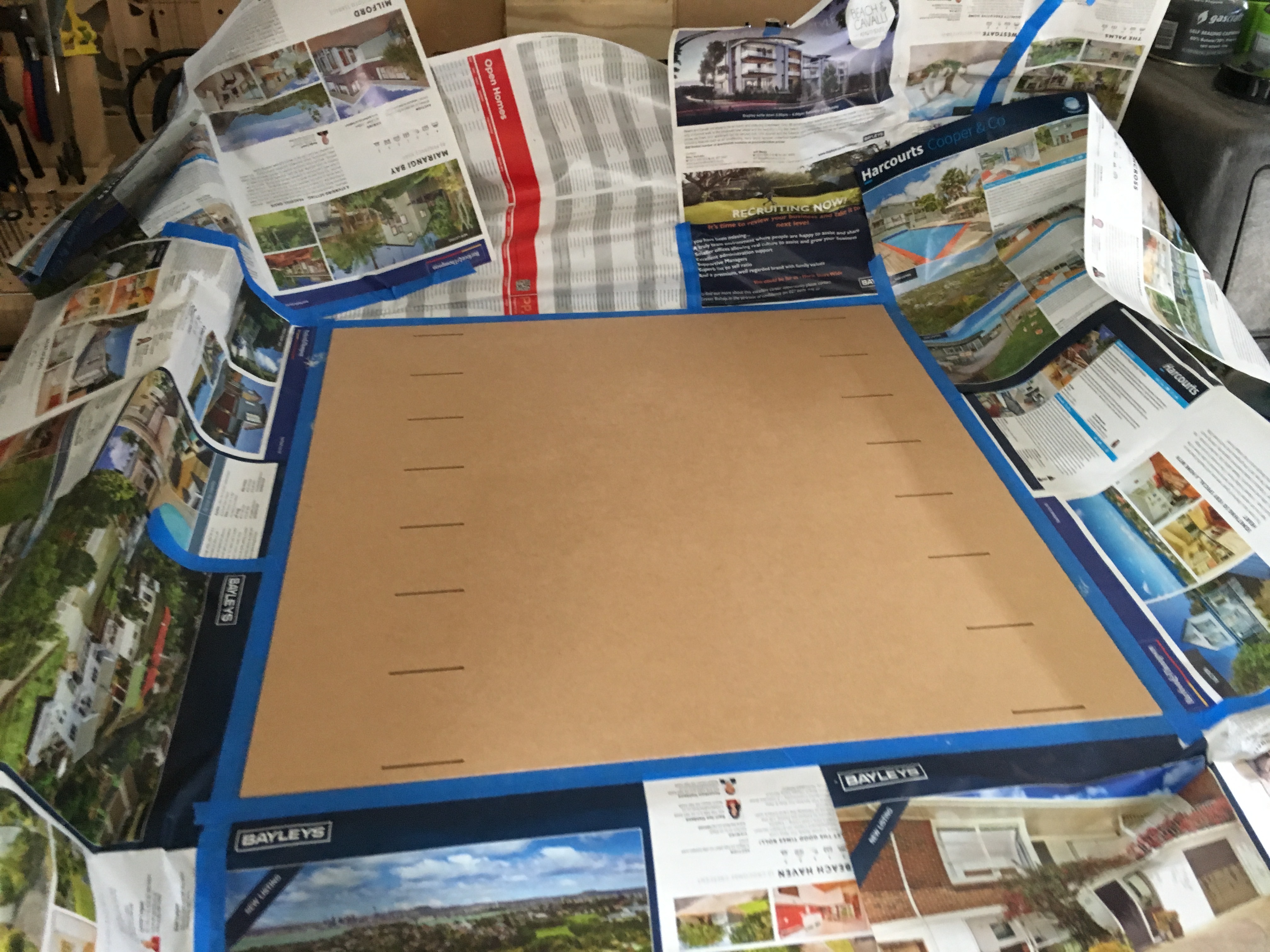

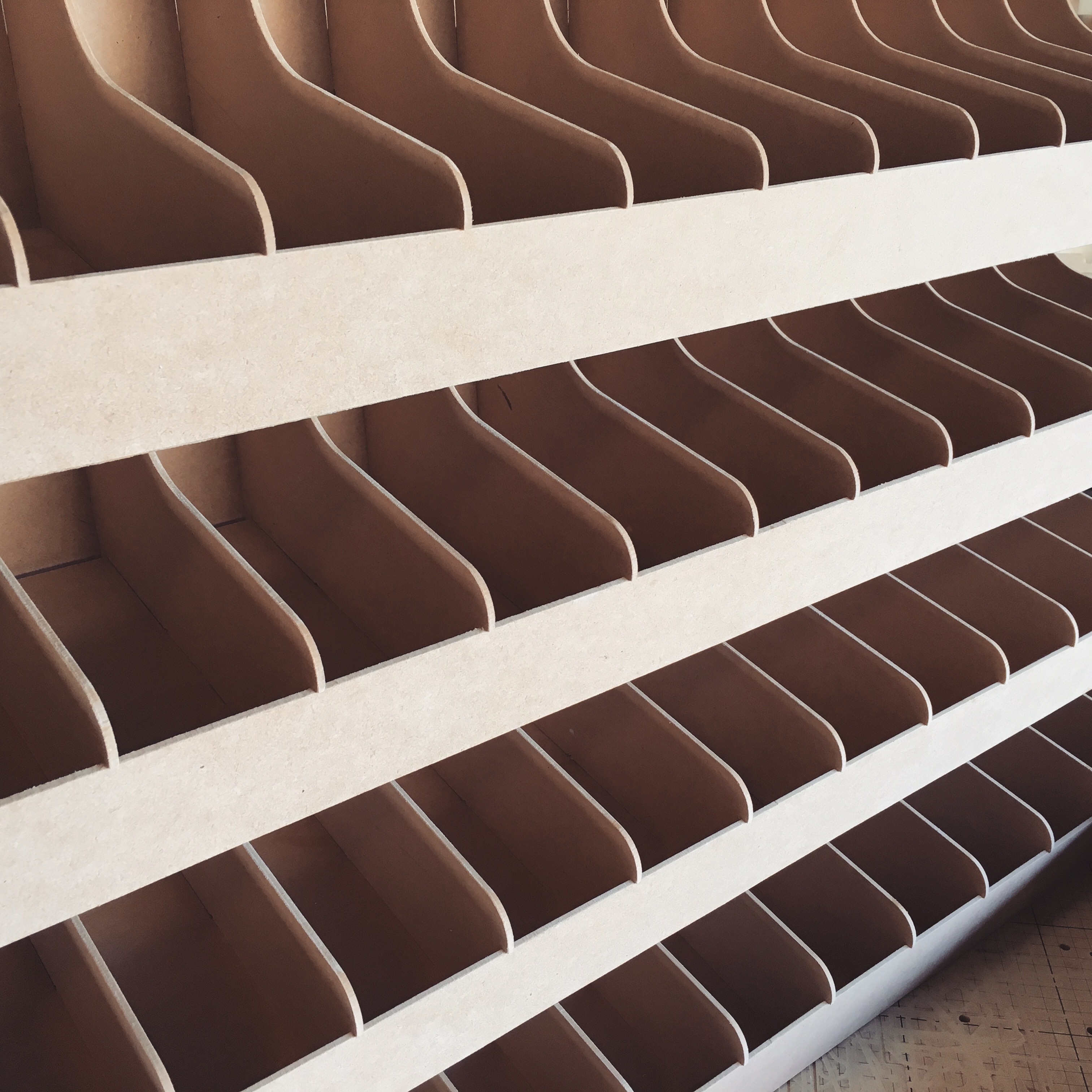

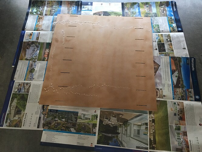

The second project is for another mate of mine who needed to sort some batteries at his shop.
Started with a Fusion 360 mockup and went from there… it is out of 3mm MDF and didn’t need to support much weight, but it ended up being pretty sturdy.

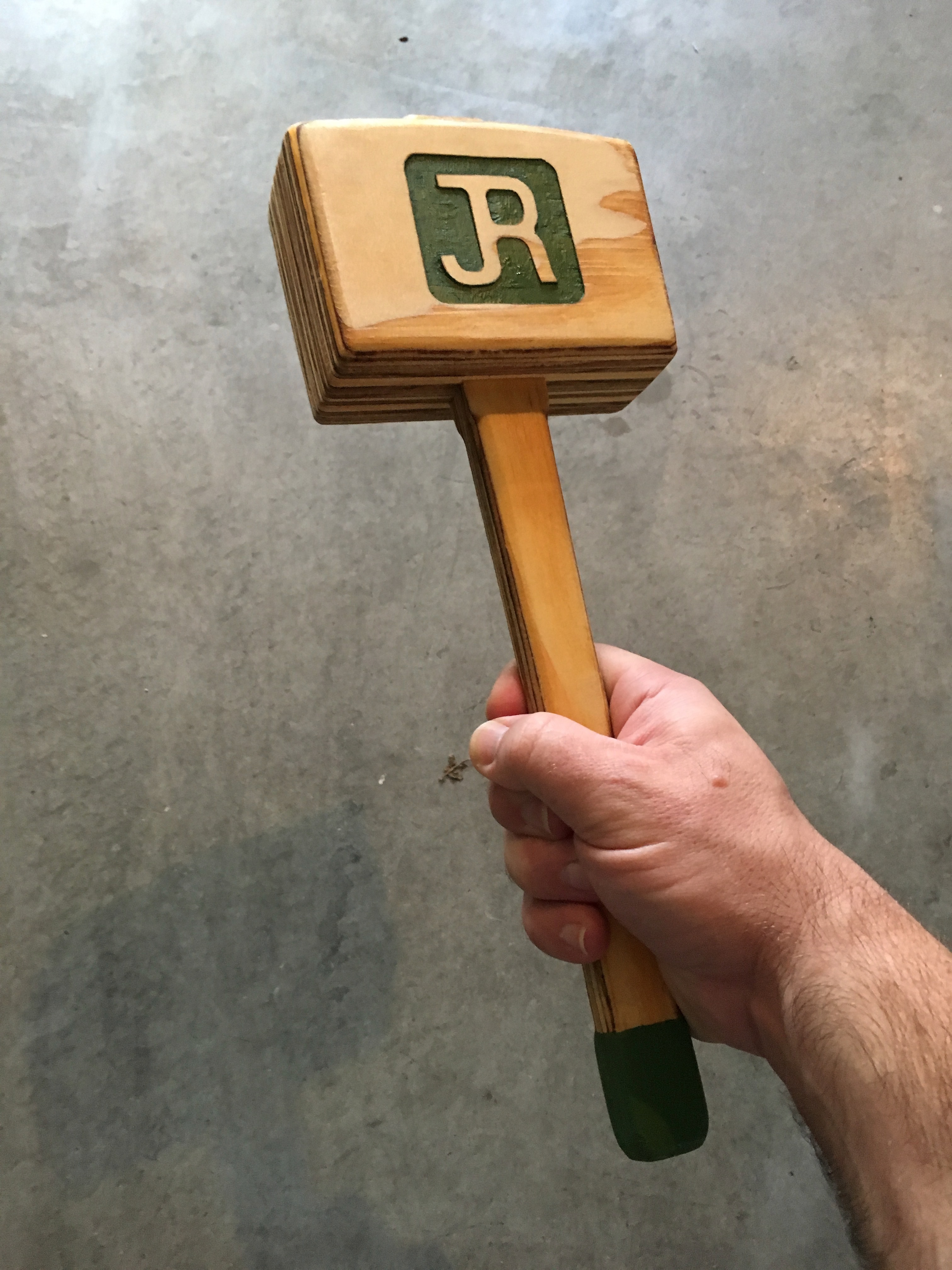

Made a wood working mallet a while back and forgot to post it.
Here’s the project: Woodworking Mallet

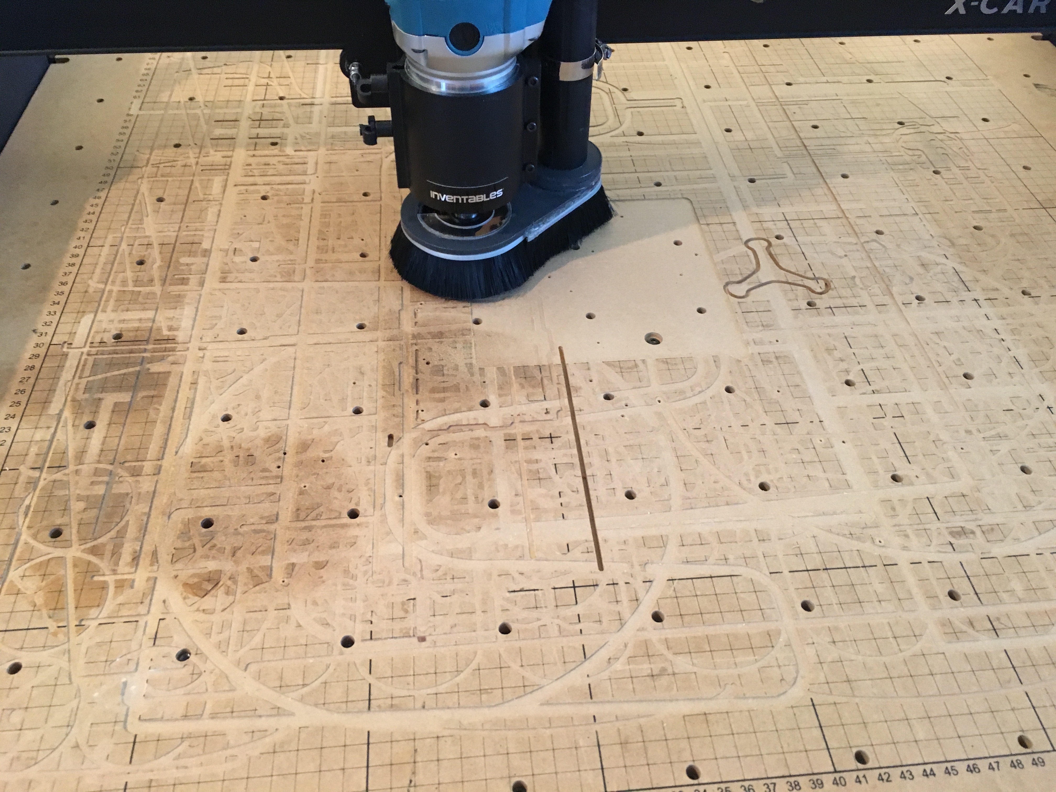

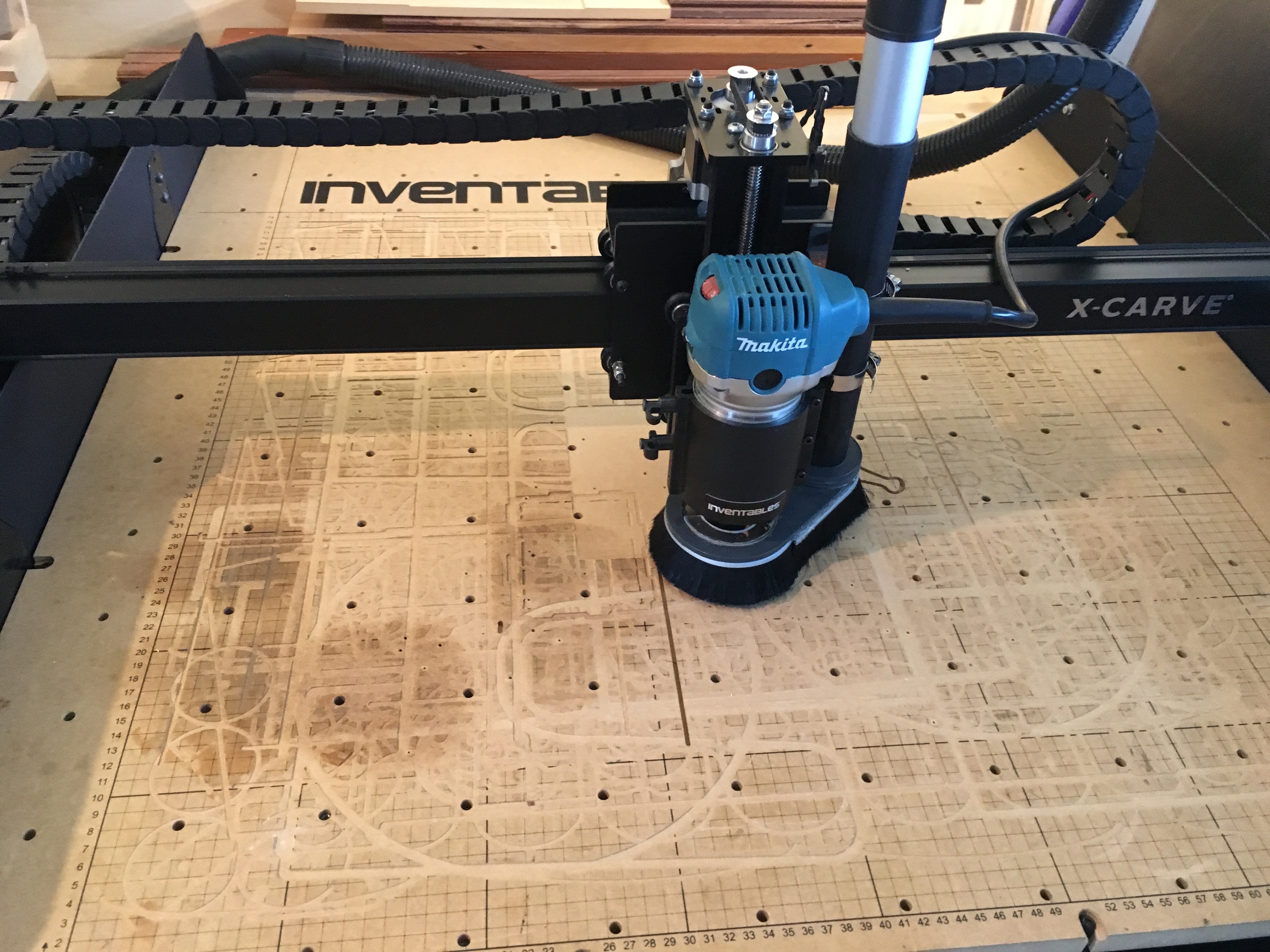

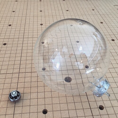

Also, I replaced the surface of my X-Carve with a new insert and milled it flat and put the grid and holes back on.
Here’s a few photos of the process:
