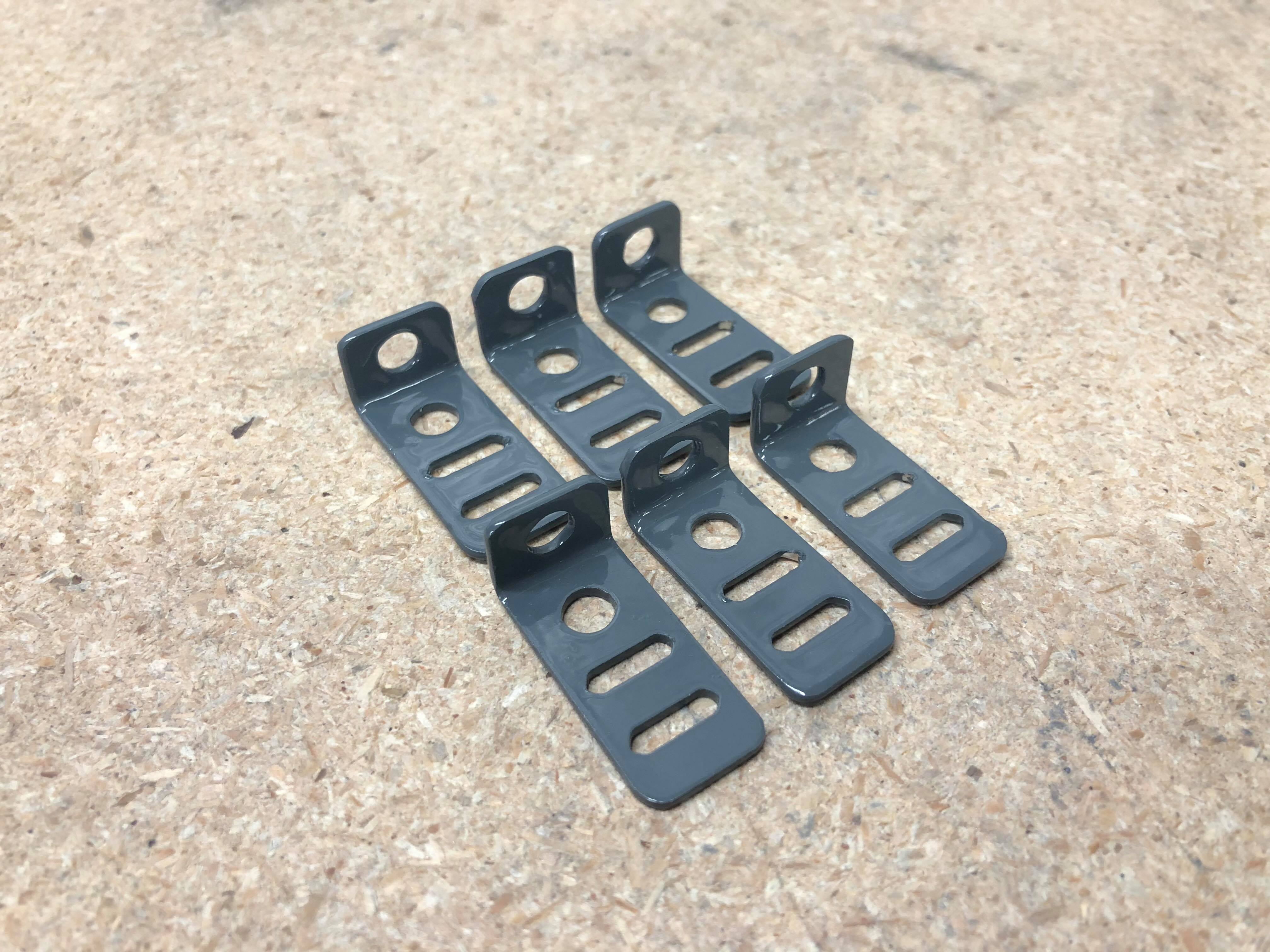

Shipping now - Powder Coated Steel 9mm Belt Clips - Only $20

What are they? 1 or 2mm thick? I’d thread the vertical hole and turn the adjusting screw around for ease of access. Even 1mm threaded steel will be plenty strong for tensioning by thread. Once the locking nut is in place there’s no force on there anyway.
Actually I would love to see one of you two make a v2 with offset holes as I did. Just better design imho as it would remedy the clearance issue. Keeping the offset minimal would assure that torque is practically negligible in this application. Only issue is you’d need a left and right clip, so 2 (mirrored) different parts.
You can slide a tee nut in front of the flange and insert the adjustment bolt from the other side. That accomplishes the same thing. Its a bit of a tight fit (on the stock & my clips, probably not as tight on phil’s), but you can get the tee but in there. Like Phil said tapping isn’t an option because of thickness.
Hey i’m not going to argue with a mechanical engineer about this stuff. I know a losing battle when I see one.
But just to throw this out there, K40 belt tensioning clips are 0.5mm threaded steel. Now I’m not in any way saying the K40 is a shining example of good mechanical design, but as many points of failure this machine features, I have yet to see documentation of one of those clips failing. Pretty nuts if you think about how little surface there is to actually grab the threads.
The thread engagement depends on a number of factors (type of bolt material, type of threaded material, how its loaded, strength requirements, etc.) The 1.5 mentioned is the general rule of thumb to avoid calculating it or confirming material strengths so you have some safety margin. This also assumes the threaded material is of lesser strength than the bolt (which is usually the case). You can do 1x if they are the same strength material (which is why nut thicknesses are not generally 1.5x, this is also noted on the page Phil linked) or up to 2x if there is a large obvious difference such as steel with aluminum.
Another thing to note that not a lot of people know is that ~75% of the load is taken by the first 3 engaged threads of the connection. So overdoing it with too many threads is not buying you anything.
So with this upgrade, you’re changing idlers and pulleys and so theoretically you have control of the horizontal space away from the Vwheels so why not only expand the stock clip away from the Vwheels to support the wider belt and just move the idlers and pulleys out to compensate so the belt stays straight and aligned but it does make the tensioning screw slightly off center but it shouldn’t be enough to cause a major issue.
Maybe this is what was being described by the offset clip?
exactly :wink:

Why are they grey, when the X-Carve is black?
Nailed it Bill. Choosing gray and upping my order volume is what allowed me to cut an additional $5 off the price. I’ve been bullied, kicked out of groups, and blocked, but I’ll take that heat if it means making upgrades more affordable to the average user.

i’ve been wanting to ask, these are laser cut; did you look into waterjet cutting also? Any reason in particular you chose one over the other?
I’m asking bc i’m also looking if I can order a batch of custom steel brackets for my K40 laser conversion. I guess I’m testing the waters, seeing what’s out there and how I best go about it. Any insight would be extremely helpful.
The shop that I work with only uses lasers, so it was an obvious choice. Generally speaking, any method of getting to the desired end result is acceptable in my mind.
